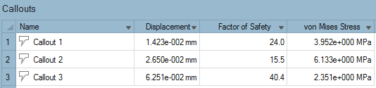

List Callouts![]() |
Display in a table all of the callouts that have been created, with
the result types and values. Each callout is specific to the selected
run and load case.![]() |
