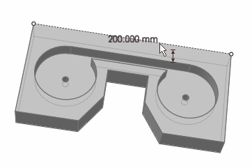

Use the Measure tool to measure geometry features including a length, an angle, and the
dimensions of a bounding box.
Location: all ribbons, Home group
Click the satellite icon that appears when you hover over the Measure tool to view
a list of all measures in your model.

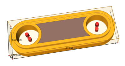

Measure Box
Use the Measure Box tool to measure the dimensions of the
bounding box for a selected part or generated shape.
From the Home tools, Measure
tool group, click the Measure Box tool.
Click the model to define the start point and end point.
A line connecting the two points appears and displays a measurement.
Dimensions persist after you exit the tool and are dynamically updated as you
modify the geometry.

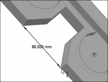

Measure Length
Use the Measure Length tool to measure not only the length
of an edge, but also the radius of a circle or an arc, and the diameter or length of a
cylinder.

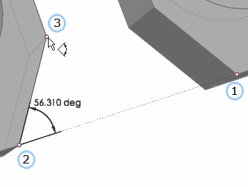

Click the model to define three sequential points.
Note: Selectable points turn red when you hover over them in the modeling window.
A measurement appears and displays the angle between the three points.
Point #2 is the vertex of the angle. Dimensions persist after you exit the tool
and are dynamically updated as you modify the geometry.
