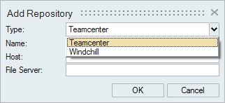

Add a Repository
Add a repository to manage files on your PDM system.
First, you'll need to:
- Integrate Inspire with your PDM system.
- Obtain the Name, Host, and File Server for the repository, which can be provided by your network administrator
Select
Add a repository.
For Type, select Teamcenter or Windchill.
- Enter the Name, Host, and File Server.
- Click OK.
