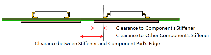

- Clearance between Component Stiffener and Component’s Pad: Check the
clearance between the component stiffener and the component
pads.
Figure 3.- Additional Void-Checking Component Selection: Add a new additional void-checking component group by selecting a component group from the list.
- Clearance between Other Component Stiffener and Component’s Pad: Check the clearance between the other component stiffener and component pads.

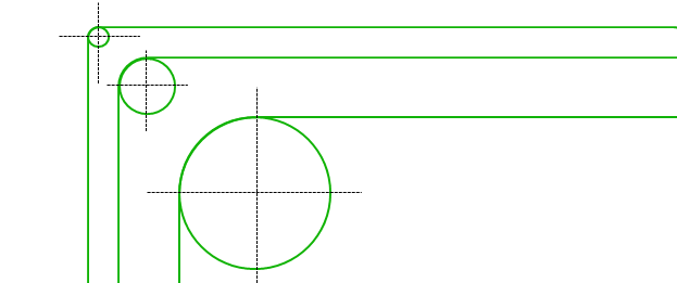

- Check Stiffener’s Rounding in Corners: Check whether stiffener
corners are rounding. To check the sharp angle, use the radius in
the corner.
Figure 4.- Minimum Radius for Stiffener’s Angle: Set the minimum radius values.

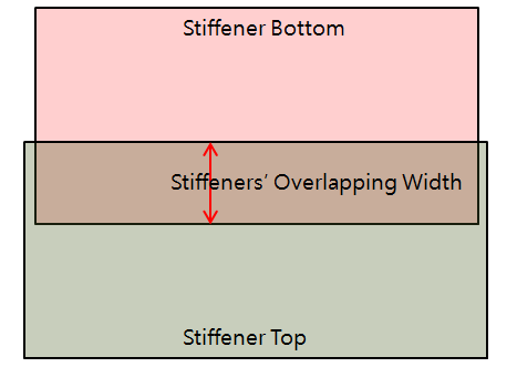

- Minimum Overlapping Width between Top and Bottom Stiffener: If there
are top and bottom stiffeners in the same area, check the
overlapping width.

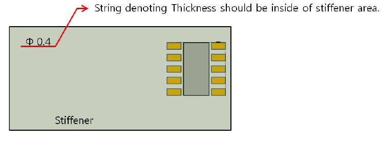

- Check Existence of String for Stiffener’s Thickness: Check if there
is text string, denoting the thickness of a stiffener in the
stiffener area. The string should be matched with given thickness
value.
Figure 6.- Define Top Placed Stiffener’s Thickness: Set the top stiffener thickness value.
- Define Bottom Placed Stiffener’s Thickness: Set the bottom stiffener thickness value.

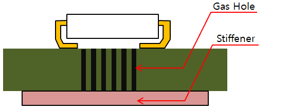

- Gas Hole Stiffener: If there are gas-holes under components, you can
make rules for gas holes.
Figure 7.- Gas Hole Layer Selection: Define the gas-hole layer by selecting a layer from the layer list.
- Minimum Gas Hole Size: Set minimum gas hole size.
- Check Existence of Gas Hole in Stiffener: Check if there are gas holes in stiffener area.
- Clearance between Gas Hole and Stiffener: Set the clearance value between gas hole and stiffener.
