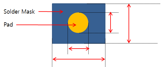

- TCP Bonding Mark Definition: Define TCP bonding marks.
- Component Selection: If TCP bonding marks are registered as a component, select them from component group list.
- Board Figure: If TCP bonding marks are designed with board figure
geometries, specify their mark size and pad size.
- Mark Size: Set the mark size X and Y.
- Pad Size: Set the pad size X and Y.

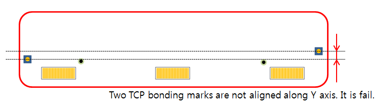

- Arrangement for Y Location: Check side edge’s TCP bonding mark
alignments along Y-axis.

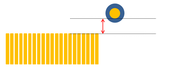

Figure 3. - Y Axis Clearance between TCP Component and TCP Mark Pad’s Edge: Set
the Y-axis clearance value between TCP component and TCP bonding
mark pad edge.
Figure 4.- Tolerance: If Y-axis values differences are within tolerance, PollEx DFM defines them as the same value.

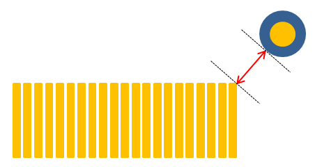

- Clearance between TCP Mark and Components: Set the clearance value
between TCP bonding mark and TCP component.

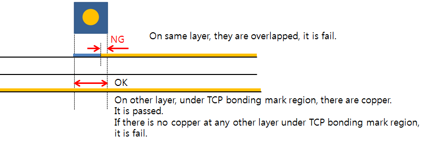

Figure 5. - Copper Existence: Check TCP bonding marks are overlapped with
copper-pour on the same layer and copper-pour existence under TCP
bonding mark region on other layer.
