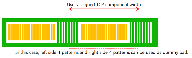

- Auto-Detection of Dummy Pad: This menu automatically detects the dummy pad in the defined area. If there is no component, all component pin and pattern dummy pad are recognized as TCP dummy pad. If there is a component, it checks using the Expand checking area based on TCP component toward major axis condition.
- Component Pin: Recognize a component pin as TCP dummy pad in the defined area.
- Pattern Dummy Pad: Recognize a pattern dummy pad as TCP dummy pad in the defined area.
- Expand checking area based on TCP component toward major axis: If
there is a component other than a component pin or a pattern dummy
pad between TCP components in the defined area, this option is used
to expand a checking area by the given value from the center point
of a TCP component.

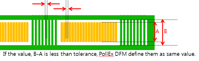

- Checking Difference in Dummy Pad Size with TCP Component Pad Size: Checks
dummy pad width compared to the width of TCP component pad. If the two
values are different, it is a fail.
Figure 4.- Width: TCP component pin width.
- Tolerance: Tolerance value between TCP dummy pad width and TCP component pin width. If the difference is less than tolerance, PollEx DFM defines the two values are the same.
- Height: TCP component pin height.
- Tolerance: Tolerance value between TCP dummy pad height and TCP component pin height. If the difference is less than tolerance, PollEx DFM defines the two values as the same.
- Except Dummy Pad near PCB Outline: Option to exclude the Dummy Pad near the PCB outline.

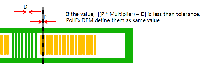

- Distance between Dummy Pads: Checks the distance between dummy pads
compared to TCP component pad distance. If they are different, it is
a fail.
Figure 5.- TCP Component Pad Distance: Distance between TCP component pins.
- Multiplier: Multiplier to TCP component pads distance.
- Tolerance: Tolerance value between TCP dummy pads distance and TCP component pins distance. If the difference is less than tolerance, PollEx DFM defines the two values as the same.
