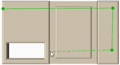

If using the Project tool:
In the microdialog, choose the X, Y, or Z axis for the projection
direction.
Click the green arrow to reverse the projection. -
Click the surface of the model to begin creating the shape of the
projection. Each left-click places a corner of the projection.
- Right-click to complete the projection.
