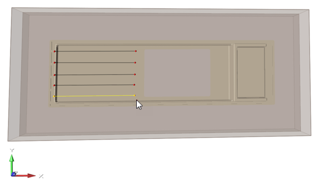

Add Line Vents
Add line vents to enable gases to travel along the part and escape from the parting line of the mold.
Click the Line Vent icon.
Click and drag to sketch a line vent on the mold. Click again to end the
vent.
Figure 1. Example of Line Vents on a PolyFoam Model
In a PolyFoam model, you sketch vents on the exterior faces of the mold for ease of use. The software projects the vents to the part and runs the simulation on the model as if the vents were located on the part.

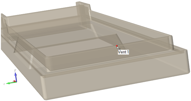

Add Point Vents
Add point vents to enable gases to escape from around the part and through the exterior of the mold.
Click the Point Vent icon.
Click a surface on the part to place a point vent.

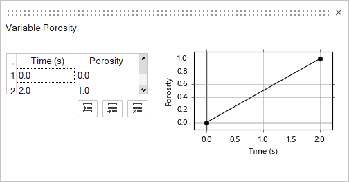

Variable porosity defines a venting system with time-dependent changes to vent porosity. You can apply variable porosity to individual point vents to siphon gases away from the part. Select the check box to enable variable porosity. To define the porosity properties, click the variable porosity button
and enter the porosity over
time in the dialog:

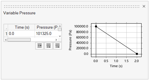

Variable Pressure
Variable pressure defines a venting system with time-dependent changes to pressure, including vacuum conditions. You can apply variable pressure to circular point vents to siphon gases away from the part. Select the check box if your model includes a pressure system. To define the pressure properties, click the variable pressure button
and enter the pressure over
time in the dialog:
