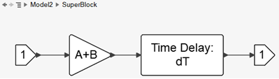

Super Block Diagram
Consider the following diagram, inside a Super Block named SuperBlock:

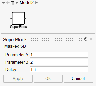

If the Super Block Context is empty, the parameters of this diagram are A,
B and dT. If the Super Block is masked, then the mask should
define these three parameters. Such a mask may look as follows:
The mask parameter names are not directly visible on the mask GUI; they can be made
visible by placing the cursor on top of the parameter description. In this case the
mask parameters are named A, B and dT. The parameter values are
defined by numerical values 1, 2 and 1.3. At this point the Super Block resembles a
library block; the mask parameters are essentially local, private variables of the
block, transparent to the user.

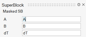

Auto-Masking
The mask for a Super Block may be created using the mask editor, or it can be
generated automatically. The auto-masking facility identifies the set of parameters
required to make the diagram inside the Super Block self-contained and use them both
as mask parameter names and values. Auto-masking, applied to the previous example,
creates the following mask:
This mask defines parameters named A, B and dT inside the Super
Block from model parameters with the same names outside the Super Block. This mask
can then be edited, in particular for providing descriptions for the parameters
(auto-masking places by default the name of the parameter in the description
field).

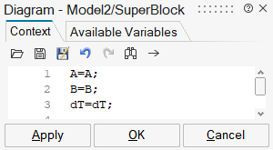

It should be emphasized that this model contains now two parameters named A,
having the same value. The same is true for B and dT. Semantically,
the presence of this mask is equivalent to placing the following instructions in the
Context of the Super Block:

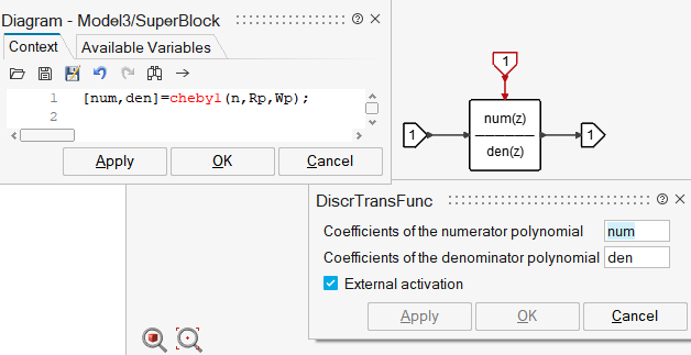

Creating a New Block with a Digital Chebyshev Filter
Consider the creation of a new block that implements a digital Chebyshev filter of
type I, based on the OML function cheby1. This function computes the
numerator and the denominator of the discrete transfer function of the filter based
on the order of the filter, its attenuation factor, and its cut-off frequency. The
Chebyshev block does not exist in Twin Activate but the discrete transfer function does.
So, a Chebyshev block can be constructed as a masked Super Block as follows:

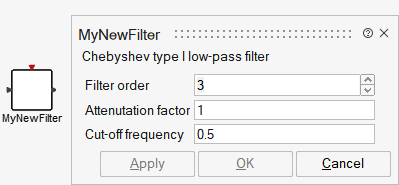

The new block can now be created by auto-masking this Super Block, and editing the
mask to provide a description for the block, and, descriptions and default values
for the parameters:
This block can now be used as such in the model or be placed in a library for wider
usage.
