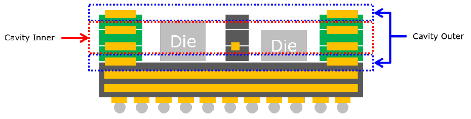

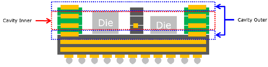

- Checking
- Clearance to Outline: Clearance checking between Cavity area and PCB outline.
- Clearance to Other Cavity: Clearance checking between cavity areas.
- Cavity(Outer) Clearance to Pattern: Clearance checking on the outer
layers that cavity applied.
- Cavity(Inner) Clearance to Pattern: Clearance checking on the inner

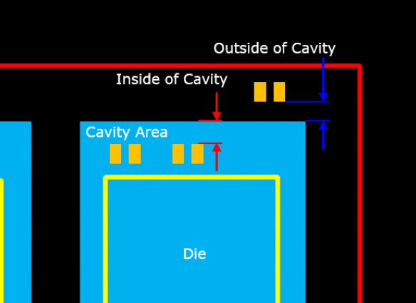

- Clearance to Component
Figure 3.
- Item: Specify the item name.
- Component Group: Select the target component group and cavity area.
- Measure: Select the measure base of target component.
- Inside of Cavity: Check the clearance between placed component within cavity area and cavity area (outer area).
- Outside of Cavity: Check the clearance between placed component out of cavity area and cavity area (outer area).
