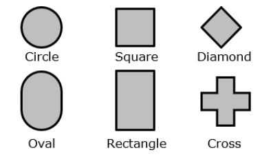

- Degassing Hole Definition
- Hole Shape: Define the hole shape of Degassing Hole.
- Width/Height: Define the width and height of Degassing Hole.

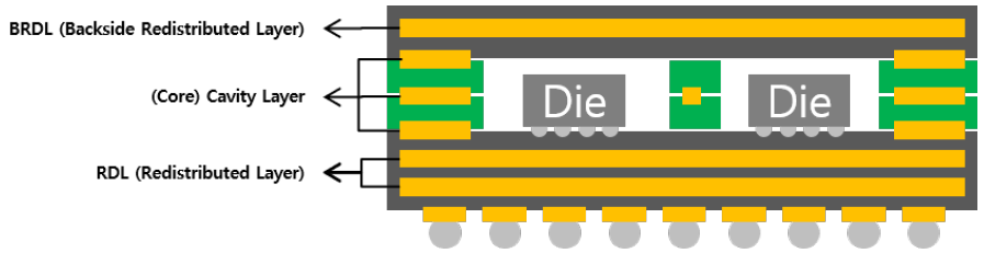

- Cavity Definition
- Define Cavity region from Specific Layer: Select a layer drawn Cavity region.
- Define Cavity Layer Stack by Name Filter: Define a layer containing a specific string as a Cavity area.
- Checking (RDL / CORE / BRDL)
- Clearance to Degassing Hole: Clearance checking between Degassing Holes.
- Same Layer: Clearance checking between the target Degassing Hole and the Degassing Hole on the same layer.
- Upper Layer: Clearance checking between the target Degassing Hole and the Degassing Hole in the upper layer.
- Lower Layer: Clearance checking between the target Degassing Hole and the Degassing Hole in the layer.
- Clearance to Pattern: Clearance checking between the Degassing Hole
and pattern.
- Same Layer: Clearance checking between the target Degassing Hole and the pattern on the same layer.
- Upper Layer: Clearance checking between the target Degassing Hole and the pattern in the upper layer.
- Lower Layer: Clearance checking between the target Degassing Hole and the pattern in the layer.
