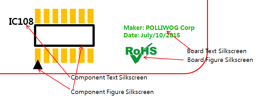

- Target Silkscreen Objects Definition
- Pads Objects: Checks pads overlapping with silkscreen data in below list.
- Component Text: Check pads overlapping with component text silkscreen.
- Board Text: Check pads overlapping with board text silkscreen.
- Component Figure: Check pads overlapping with component figure silkscreen.
- Board Figure: Check pads overlapping with board figure silkscreen.
- Vias Objects: Checks vias overlapping with silkscreen data in below list.
- Component Text: Check vias overlapping with component text silkscreen.
- Board Text: Check vias overlapping with board text silkscreen.
- Component Figure: Check vias overlapping with component figure silkscreen.
- Board Figure: Check vias overlapping with board figure silkscreen.
