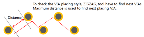

- Zigzag Checking for Via: Finds vias on design and checks if they are
placed in zigzag style. If they are not matching with zigzag style,
PollEx DFM finds that locations and
defines them as fails.
- Select Target Vias in given maximum Distance: Set the
maximum distance value between two vias.
- Shape (Edge to Edge) / Location: To define zigzag style of
via placement, tool should find next via. To do find next
via, tool use distance from base via to another via.
