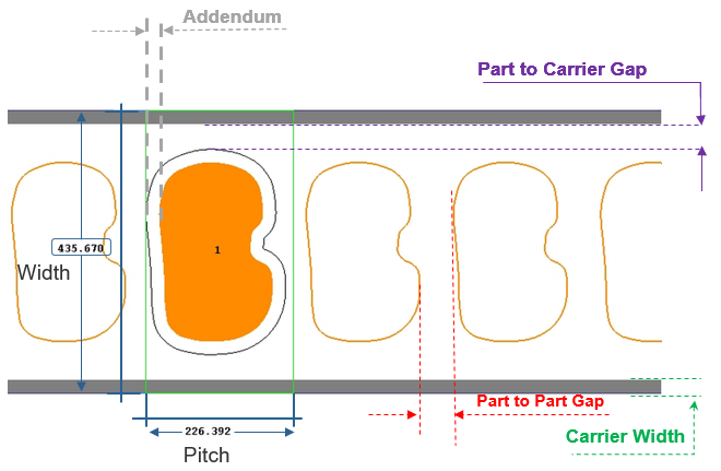

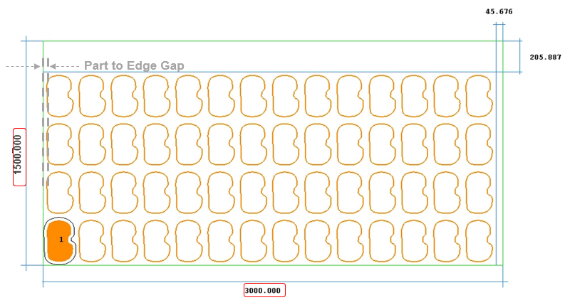

Blank Nesting
| Preference | Description |
Enter a value.![]() Note: If no value is entered, the coil
width and pitch are optimized for maximum material
utilization. |
Enter a value.![]() Note: Sheet width and length are
required for nesting on a given sheet stock. |
