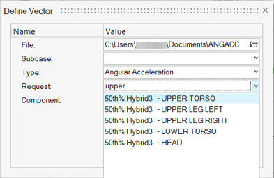

Vector (Entity Type) Properties
- Data
- Source
- The source type: File, Math, or Values.
- File
- If Source is File, the file path is displayed.
- Expression
- If Source is Math, the math expression is displayed.
- Values
- If Source is Values, the vector data values are displayed.
- Subcase
- Displays the subcase.
- Type/Request/Component
- Displays the type, request, and component data for the vector.
