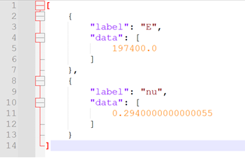

- A global property associated with all nodes in a model such as material properties (Young’s Modulus, Poisson’s ratio) can be supplied by creating a .json file with the same name and in the same location as each of the .h3d files. A custom python script, global_hook.py, is needed.

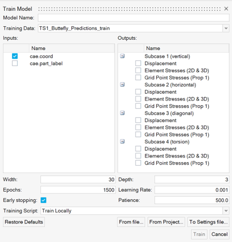

If only .h3d files are provided, the nodal coordinates and part ID are imported by default. Only the nodal coordinates are enabled by default.

Inside the training_files folder, there are seven .h3d files named run__000X_m_1_fillet_cantilever_2.h3d and seven .json files named run__000X_m_1_fillet_cantilever_2.json files. Each .json file contains exactly two material properties, Young’s modulus and Poisson ratio with different values. It is necessary to have consistent labels and number of properties across all the samples.

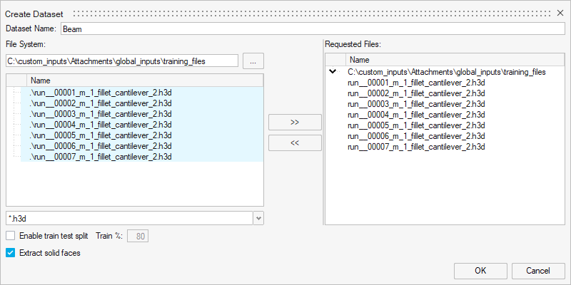

Create a new dataset using all seven samples and name it Beam.

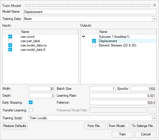

Train the model.

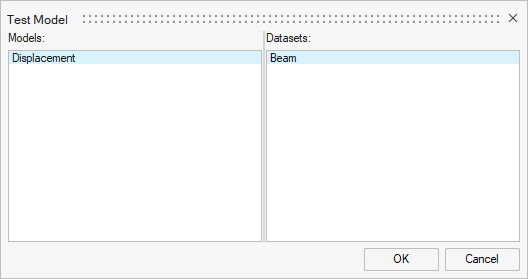

Test the model.
New samples can be generated by copying and renaming one or more training files. Ensure that the associated .json files are also present with different values of E and nu while creating the test dataset.
