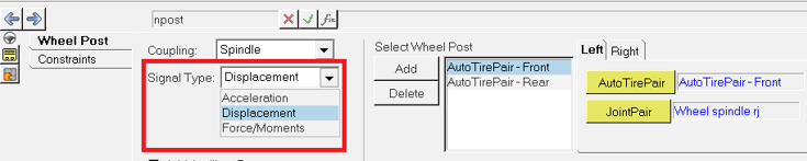

From the Wheel Post tab, select Displacement from the
Signal Type drop-down menu.
Figure 9. There are three signal types that can be used for the input to spindle coupled arrangement:- Displacement
- Acceleration: Acceleration is converted to displacement. The signal manager performs the conversion by integrating the acceleration to velocity and the velocity to displacement. At each step, the signal is conditioned by a band pass filters with limits of 0.5 Hz and 1000 Hz.

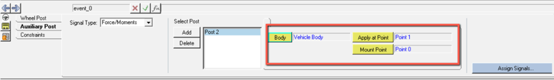

Auxiliary posts may be used to include excitations other than the road surface, such as aerodynamic forces and/or lateral disturbances. The auxiliary posts can be added at any location and the model can have as many posts as needed.
From the Wheel Post tab in the panel, check the Add Auxiliary
Posts option check box.
Figure 21. -
In the Auxiliary Post tab, select Force/Moment from the
Figure 22. -
Click on Add to create an Auxiliary Post.
Figure 23. - Create two pints with coordinates Point_0 (0,0,1500) and Point_1 (500,0,1500).
Select Vehicle Body for Body,
Point_1 for Apply at Point, and
Point_0 for Mount Point.
Figure 24. Attachments for each Auxiliary Post consists of Body, Apply at Point, and Mounting Point. The direction of Displacement/Force application is from Mount Point to Apply at Point.Figure 25. Note:- A ball joint is used between the actuator tube body and the ground.

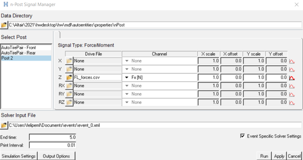

Click on Assign Signal.
The created Auxiliary Post is now shown under the Select post option in the n-Post Signal Manager.
Figure 26. - Enter FL_force.csv in the Z signal type field and Run the simulation.
