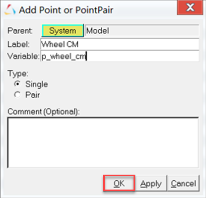

The Add Point or PointPair dialog opens. - For Label, enter Wheel CM.
- For Variable, enter p wheel cm.
Click OK.
The Wheel CM point is added in the Project Browser.Figure 6.

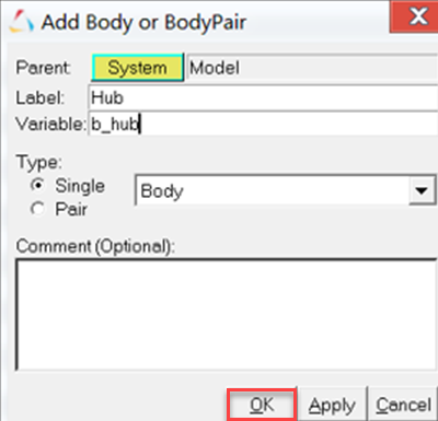

The Add Body or BodyPair dialog opens. - For the Label, enterHub.
- For the Variable, enter b_hub.
Click OK.
The Hub body is added to the Project Browser.Figure 10.

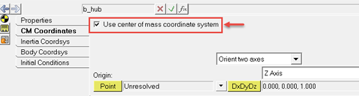

From the Body panel, click on the CM Coordinates tab and
select the Use center of mass coordinate system check
box.
Double-click the Point collector button.
The Select a Point dialog opens. -
Select the Wheel CM point and click OK.
The center of the wheel is used as the center of the Hub body.Figure 14.

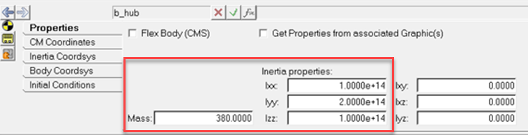

Update the Mass and Inertia Properties of the Hub Body
In this step, you will update the mass and inertia properties of the Hub body.
- From the Body panel, enter 380 as the Mass property in the Properties tab.
- In the Inertia properties section, enter 1.0000e+14 for lxx.
- For lyy, enter 2.0000e+14.
For lzz, enter 1.0000e+14.
Tip: The mass and inertia properties of the Hub body should now match Figure 15.

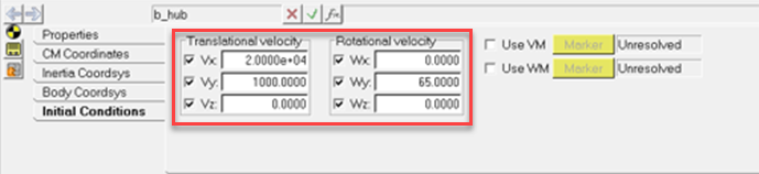

- Click on the Initial Conditions tab.
- In the Translational velocity section, enter 2.0000e+04 for Vx.
- For Vy, enter 1000.
- For Vz, enter 0.
- In the Rotational velocity section, enter 0 for Wx.
- For Wy, enter 65.
For Wz, enter 0.
Tip: The initial conditions for the Hub body should match Figure 16.
Note: These initial conditions applied at the Hub body represent a tire+rim with an initial forward velocity Vx of 20000mm/s and rotating at 65rad/s.

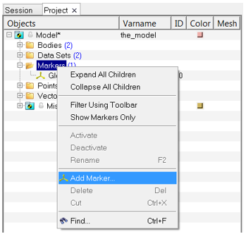

From the Project Browser, right-click the
Markers folder and select Add
Marker from the context menu.

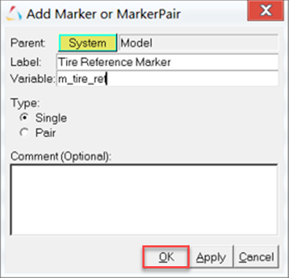

The Add Marker or MarkerPair dialog opens. - For Label, enter Tire Reference Marker.
- For Variable, enter m_tire_ref.
Click OK.
Figure 18.
The Tire Reference Marker is added to the Project Browser.Figure 19.

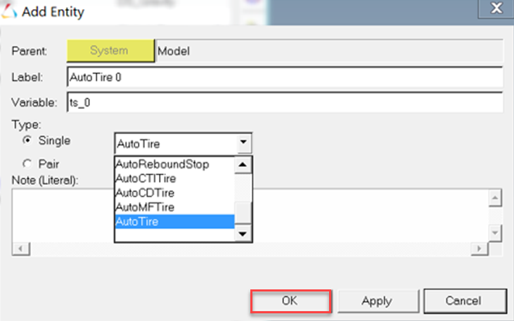

Model and select Add Auto
Entity from the context menu.
The Add Entity dialog opens. -
From the drop-down menu, select AutoTire and click
OK.
Figure 22.
The AutoTire panel is displayed in the panel area and the auto entity is created in the Project Browser.Figure 23.
