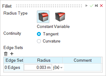

Fillet Edges
Round edges to create fillets with a constant or variable radius.
On the Geometry ribbon, select the
Fillet Edges tool.
The guide panel appears.
Choose a Radius Type:
- Constant: Create fillets with the same radius for every edge.
- Variable: Create fillets with a variable radius at selected points along the edges.
Choose a Continuity type:
- Tangent: Force tangent (G1) continuity along the edge.
- Curvature: Force curvature (G2) continuity along the edge.
Create and modify edge sets:
To Do this Add an edge set - Click the + button and select the edges.Tip: In the microdialog, select Tangent Propagation so that clicking an edge will also select all of its tangent edges.
To select all of the boundary edges of a face, click the face.
- You can adjust the Radius for each edge set.
Delete the current edge set Under Edge Sets, click
. - Click the + button and select the edges.
Create a modify points (Variable radius only):
To Do this Add a point where the radius varies Click along the edge. Delete selected points - Under Points, click
. - Alternatively, in the modeling window, select a radius handle and press Delete.
Modify the point’s position along the edge Enter a value from 0 to 1, where 0 and 1 correspond to the edge’s endpoints and 0.5 corresponds to the mid of the chain. You can also select the radius handle and drag it along the edge. - Under Points, click
Click Apply.
