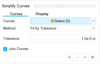

The guide panel appears. By default, the Curves tab is open.
- Select
Next to Curves, the Select button is active. Select one
or more curves.
By default, the curve is simplified using the Fit by Tolerance method and, if you selected multiple curves, they are joined.
Select a method:
- Fit By Tolerance: By default, the simplified curve fits the Modeling tolerance defined in the Preferences. To define a custom tolerance, turn on Custom Tolerance, and then enter the Tolerance. Increase the tolerance to decrease the number of points.
- Fit By Number of Points: Type the number of Control Points. You can also enter the Degree of the curve.
- Reduce Points: Only applies to NURBS curves. Reduce the number of control points in the input curve. You can use Fit By Tolerance to create an approximation of the original curve with fewer points, but you should use the Reduce Points method to collapse control points on the original curve.By default, the simplified curve fits the Modeling tolerance defined in the Preferences. To define a custom tolerance, turn on Custom Tolerance, and then enter the Tolerance. Increase the tolerance to decrease the number of points.
- Arc Length Parametrization: Parametrize the curve by arc length.
