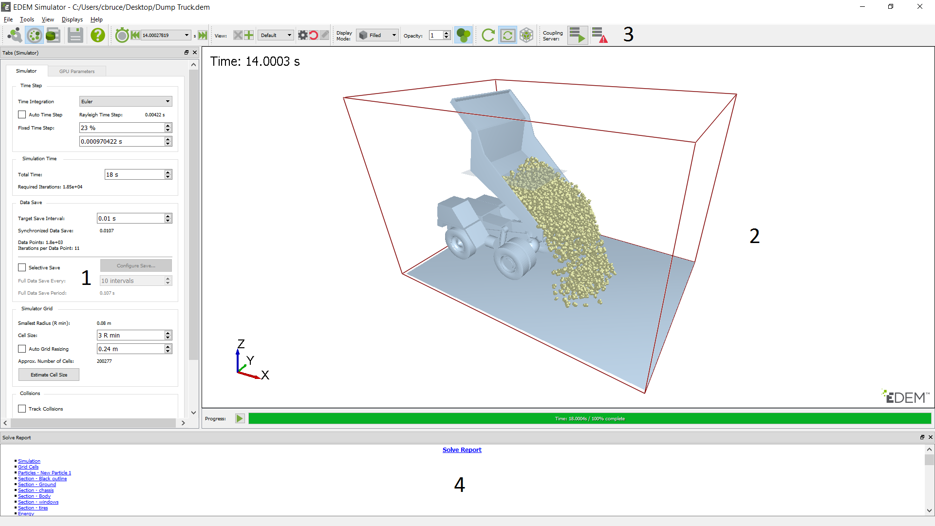

The Simulator Pane
The Simulator pane is where you define the Time Step, simulation time, grid options and Simulator Engine for the CPU mode.
The Viewer
The Viewer displays 3D representations of your particles, Geometry, and fields (if applicable). You can control the rotation, position, and zoom factor of the Viewer using a mouse. There are a number of animation controls displayed below the Viewer.
You can set up more than one display by splitting the screen in order to see the progress of the simulation from different points of view. The simulation start/stop button and simulation progress bar are located below the Viewer.

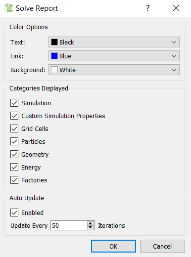

Solve Report
.html page that displays detailed information
about your model. It provides detailed information from the last refresh point which
may not be the current simulation time.
- In the Simulator tab, right-click the tool bar, and click Solve Report to launch the Solve Report in case it is disabled.
- You can move and position the Solve Report below the 3D Viewer, above the Simulator settings, or in place of the Simulator Settings where you can navigate back and forth between the Solve Report and Simulator settings.
- Right-click the Solve Report and select Save to save
the information in an
.htmlfile. - Right-click the Solve Report and select Refresh to update the information to the current simulation time.
| Color Options | |
| Text | Changes the color of the text used in the Solve Report |
| Link | Changes the color of the hyperlinks used in the Solve Report |
| Background | Changes the background color of the Solve Report |
| Categories Displayed | |
| Simulation | Shows statistics related to the entire simulation in the Solve Report |
| Custom Simulation Properties | Shows details of the Custom Properties in the Solve Report |
| Grid Cells | Shows details of the cell grid size (only if you have selected the CUDA Solver) in the Solve Report |
| Particles | Shows details related to particles in the Solve Report |
| Geometry | Shows details related to Geometry in the Solve Report |
| Energy | Shows statistics related to energy in the Solve Report |
| Factories | Shows statistics related the factories in the Solve Report |
| Auto Update | |
| Enabled | Updates the Solve Report at regular intervals |
| Update Every <n> Iterations | Modifies the number of intervals used to update the Solve Report |
