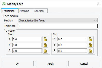

- Select a face to apply a characterised surface.
- From the right-click context menu, select Properties.
On the Modify Face dialog, click the
Properties tab.
Figure 1. The Modify Face dialog (Properties tab).
- In the Medium drop-down list, select the characterised surface to apply to the face.
- In the Thickness field, specify the thickness of the characterised surface (only supported for MoM/MLFMM).

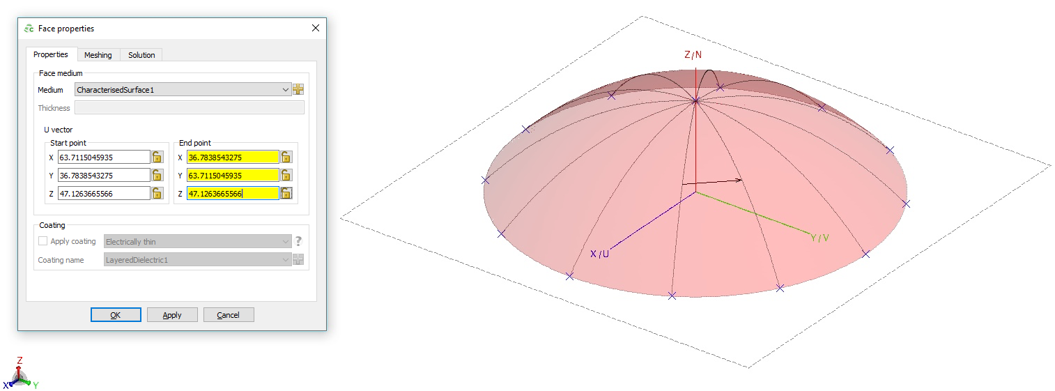

Under U-Vector, specify the start
point and end point for the U-Vector. The vector is not
required to be exactly in the plane of the face, since it is projected onto the
face, but it should be approximately parallel to the face.
Figure 2. The display in CADFEKO when setting the U-Vector. Opacity settings were modified in order to see the U-Vector preview.
Click OK to apply the characterised surface and to
close the dialog.

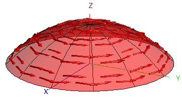

The U-Vector can be displayed in POSTFEKO to verify that all faces have the correct settings and U-Vector orientations applied.
Figure 3. Characterised surface orientation displayed in POSTFEKO where each face has a different U-Vector applied.
