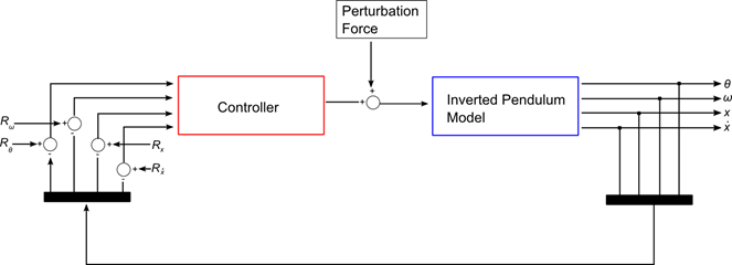

Consider an inverted pendulum, mounted on a cart. The pendulum is constrained at its base to the cart by a revolute joint. The cart is free to translate along the X direction only. The pendulum is given an initial rotational velocity causing it to rotate about the base.
- is the angular displacement of the pendulum from its model configuration
- is the angular velocity of the pendulum about its center of gravity as measured in the ground frame of reference
- is the translational displacement of the cart measured from its model configuration in the ground frame of reference
- is the translational velocity of the cart measured in the ground frame of reference
- is a reference signal for the pendulum's angular displacement
- is a reference signal for the pendulum's angular velocity
- is a reference signal for the cart's translational displacement
- is a reference signal for the cart's translational velocity
A disturbance is added to the computed control force to assess the system response. The controller force acts on the cart body to control the displacement and velocity profiles of the cart mass.

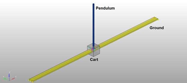

Figure 3. The MotionSolve Model of the Inverted Pendulum
The MotionSolve model consists of the following components:
Component Name Component Type Description Slider cart Rigid body Cart body Pendulum Rigid body Pendulum body Slider Trans Joint Translational joint Translational joint between the cart body and the ground Pendulum Rev Joint Revolute joint Revolute joint between the pendulum body and the cart body Control Force Vector force The control force applied to the cart body Output control force Output request Use this request to plot the control force Output slider displacement Output request Use this request to plot the cart's displacement Output slider velocity Output request Use this request to plot the cart's velocity Output pendulum displacement Output request Use this request to plot the pendulum's displacement Output pendulum velocity Output request Use this request to plot the pendulum's velocity Pendulum Rotation Angle Solver variable This variable stores the rotational displacement of the pendulum via the expression AY() Pendulum Angular Velocity Solver variable This variable stores the rotational velocity of the pendulum via the expressionVY() Slider Displacement Solver variable This variable stores the translational displacement of the cart via the expression DX() Slider Velocity Solver variable This variable stores the translational velocity of the cart via the expression VX() -

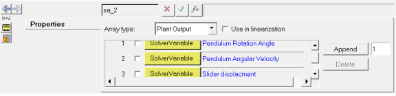

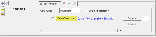

Plant Input Simulink | Plant input | This Control_PlantInput element is used to define the inputs to the MotionSolve model |
Plant Output Simulink | Plant output | This Control_PlantOutput element is used to define the outputs from the MotionSolve model |
The inputs specified using the Control_PlantInput and Control_PlantOutput elements can be accessed using the PINVAL() and POUVAL() functions, respectively. Since the Control_PlantInput and Control_PlantOutput list the IDs of solver variables, these input and output variables may also be accessed using the VARVAL() function. For more details, please refer to the MotionSolve User's Guide.
This model has the following connections:
- Plant Input: A single control force that will be applied to the cart.
- Plant Output: The pendulum's angular displacement and angular velocity; the cart's translational displacement and velocity.

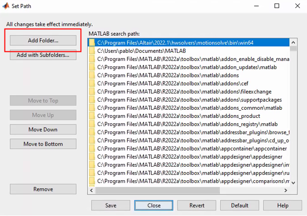

The location of this file needs to be added to the search path of MATLAB for the S-Function to use
mscosimipc
This can be done in one of the following ways:
Use the menu options.
Use MATLAB commands.

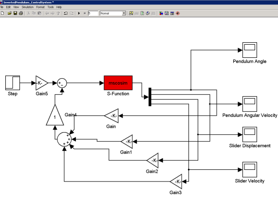

You will see the control system that will be used in the co-simulation.
Figure 7. The Control System in MATLAB
The model contains an S-function block. Name the S-function
'mscosim'. Double click on the S-Function named
mscosim. In the dialog box that is displayed, change the
name of the S-function to ‘mscosimipc’.
The S-function (system-function) is one of the blocks provided by Simulink and represents the MotionSolve model. It can be found in the Simulink User-Defined Functions block library. An S-Function allows you to model any general system of equations with inputs, outputs, states, and so on, and is somewhat analogous to a Control_StateEqn in MotionSolve. See the MATLAB/Simulink documentation for more details.
Double-click the S-function with name mscosimipc. In the
dialog that is displayed, under the S Function Parameters, enter the following
using single quotes:
'InvertedPendulum_Cosimulation.xml', 'InvertedPendulum_Cosimulation.mrf', ''

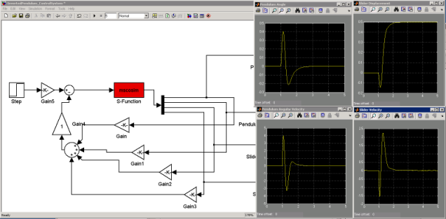

Perform the Co-simulation
Click
to start the co-simulation. Simulink uses ODE45 to solve the Simulink model. From this, the co-simulation should begin and MotionSolve should create an output .mrf file for post-processing.
- Set the Scopes in the Simulink model to display the results.
Check the .log file to make sure no errors or warnings
were issued by MotionSolve.

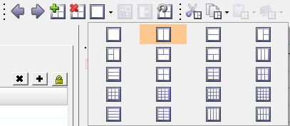

In the Page Controls toolbar, create two vertical plot windows.
Figure 9. Create Two Plot Windows
