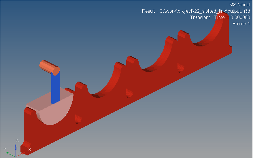

You can import the H3D file generated by this tutorial into MotionView for post-processing. The animation below illustrates the motion of the slotted link when the cam rotates.
