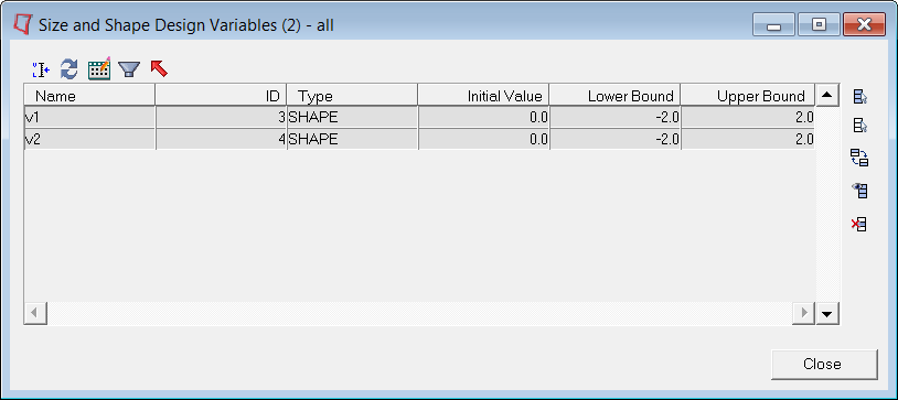

In the Size and Shape Design Variables dialog, review the
pre-defined, v1 and v2 design variables and then click
Close.
The pre-defined design variables, v1 and v2, have an Initial Value of 0.0, Lower Bound of -2.0, and Upper Bound of 2.0.

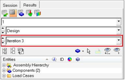

Figure 3.
In the Results Browser, select Iteration
3.

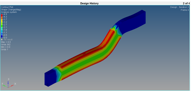

On the Results toolbar, click
to open the Contour panel.
- Set the Result type to Shape Change (v) and Mag.
- Click Apply.
Animate the results.
Figure 5.
Figure 6.

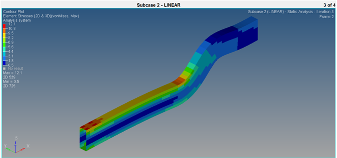

View the Stresses
In the top, right of the application, click
to proceed to the next page (page 3 of 4), which contains the Linear analysis results.
- Set the Result type to Element Stresses (2D&3D)(t) and vonMises.
- In the Results Browser, select the final iteration (Iteration 3).
- Click Apply.
