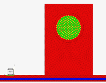

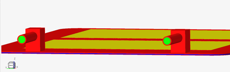

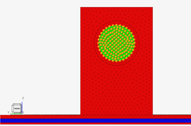

The finite element mesh contains of non-design solid (red), non-design solid with thermal loading (yellow), non-design fluid (green) and the design space (blue), which is a layer between upper and lower plate.
Figure 1. Model
Figure 2. Design Space
The finite element model representing the designable and non-designable material is imported into HyperMesh. Appropriate properties, boundary conditions, loads, and optimization parameters are defined and the OptiStruct software determines the optimal cooling channel.

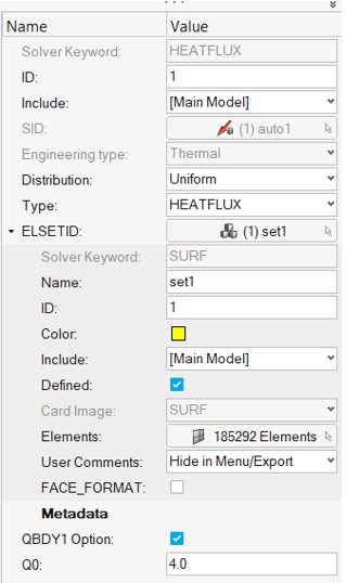

Apply Heat Flux
  1. In the Model Browser, double-click Components to open the Components Browser.
  2. Right-click on the PSOLID_4 component and select Isolate.

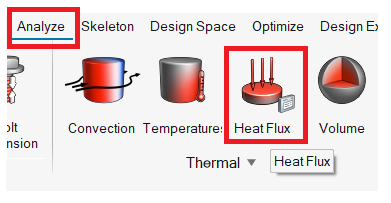

  3. From the menu bar, open the Analyze ribbon.
  4. On the ribbon, select Heat Flux.
    Figure 5. Select Heat Flux Load
  5. For ELSETID, select the hamburger menu and click Create.
  6. For Name, accept the default Set 1.
  7. Select elements by faces and choose the front faces of the PSOLID_4 component.
  8. For QBDY1 Option, ensure Q0 is set to 4.0.
  9. Click Close.

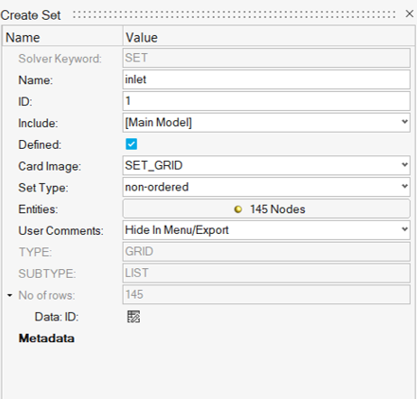

Create Inlet Node Set
  1. Un-isolate all other parts.
  2. In the Model Browser, right-click and select Create > Set.
  3. For Name, enter inlet.
  4. For Card Image, select SET_GRID.

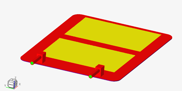

  5. For Entities, select the nodes as shown in Figure 7.
    Figure 7. Selection of Inlet Nodes
    Figure 8. Create Inlet Node Set
  6. Click Close.

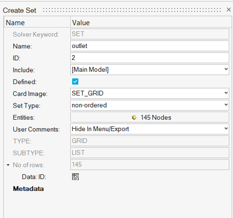

Create Outlet Node Set
  1. In the Model Browser, right-click and select Create > Set.
  2. For Name, enter outlet.
  3. For Card Image, select SET_GRID.
  4. For Entities, select the nodes as shown in Figure 9.
    Figure 9. Selection of Outlet Nodes
    Figure 10. Create Outlet Node Set
  5. Click Close.

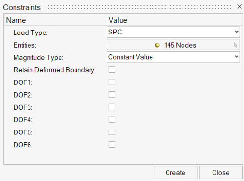

  4. From the menu bar, open the Analyze ribbon.
  5. On the ribbon, click Constraints.
    Figure 11. Assign Thermal Boundary
  6. For Entities, select Nodes.
  7. Select the nodes of the inlet faces.
  8. Clear the check boxes for DOF1, DOF2, DOF3, DOF4, DOF5, and DOF6.
  9. Click Create and Close.

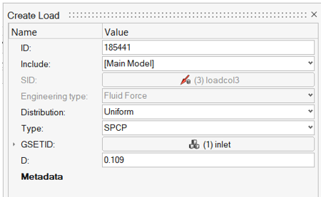

Create Inlet Pressure and Outlet Pressure
  1. In the Model Browser, right-click and select Create > Load Collector.
    A default load collector displays in the Entity Editor.
  2. For Name, enter loadcol2.
  3. Click Close.
  4. In the Model Browser, right-click and select Create > Load.
  5. For Load Type, select SPCP.
  6. For GSETID, select Unspecified > Set > inlet.
  7. For D, enter 0.109.
  8. Click Close.
    Figure 12. Create Inlet Pressure

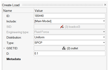

  9. Similarly, create the outlet pressure under the same load collector. In the Model Browser, right-click and select Create > Load.
  10. For Load Type, select SPCP.
  11. For GSETID, select Unspecified > Set > outlet.
  12. For D, enter 0.1.
  13. Click Close.
    Figure 13. Create Outlet Pressure

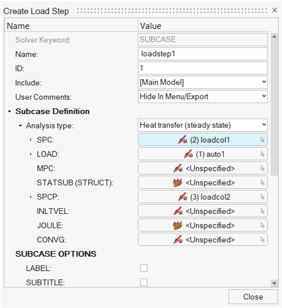

Create Subcase
  1. In the Model Browser, right-click and select Create > Load Step.
  2. For Name, enter loadstep1.
  3. For Analysis type, select Heat Transfer (Steady State).
  4. In the Select Loadcol dialog for SPC, select loadcol_1.
  5. For LOAD, select auto_1.
  6. For SPCP, select loadcol_2.
  7. Click Close.
    Figure 14. Create Load Step

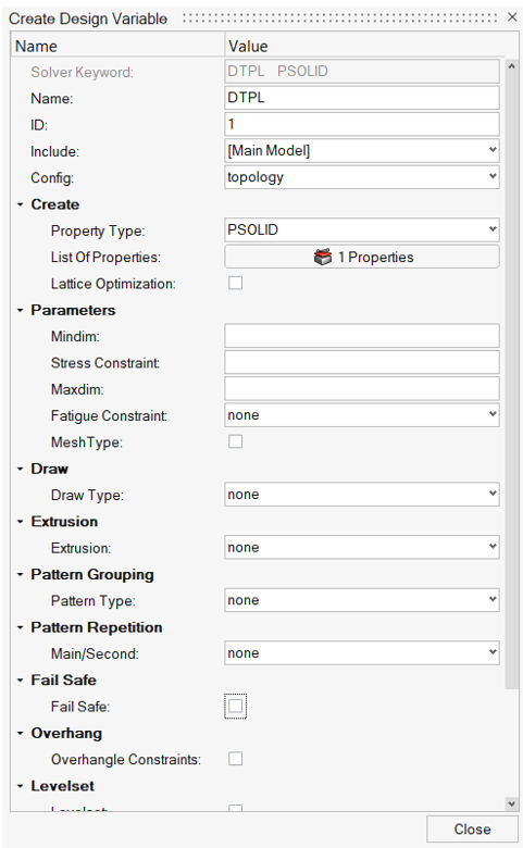

Create Topology Design Space
  1. From the menu bar, open the Optimize ribbon.
  2. On the ribbon, select Topology.
  3. For Name, enter DTPL.
  4. For Property Type, select PSOLID.
  5. For List Of Properties, select property PSOLID_3.
    Figure 15. Create Design Variable

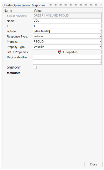

Create Responses
  2. On the ribbon, select Responses.
  3. For Name, enter VOL.
  4. For Response Type, select volume.
  5. For Property, select PSOLID.
  6. For Property Type, select by entity.
  7. For List Of Properties, select property PSOLID_3.
  8. Click Close.
    Figure 16. Create Optimization Responses

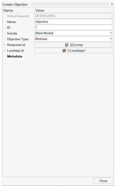

Create Objective
  2. On the ribbon, select Objectives.
  3. For Objective Type, select Minimize.
  4. For Response Id, click Optimization Response > tcomp.
  5. For Loadstep Id, click Optimization Response > loadstep1.
  6. Click Close.
    Figure 17. Create Objective

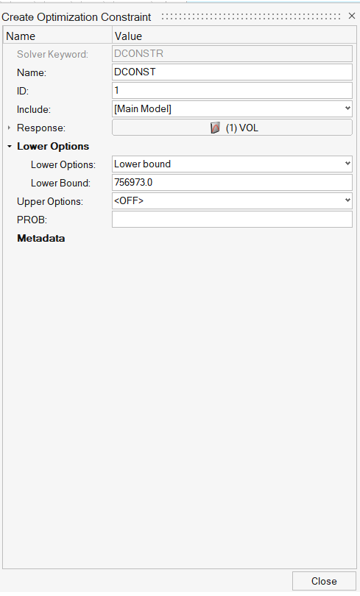

Create Constraints
  2. On the ribbon, select Constraints.
  3. For Name, enter DCONST.
  4. For Response, click Optimization Response > VOL.
  5. For Lower Options, select Lower Bound and enter 756973 in the text box.
  6. Click Close.
    Figure 18. Create Constraints

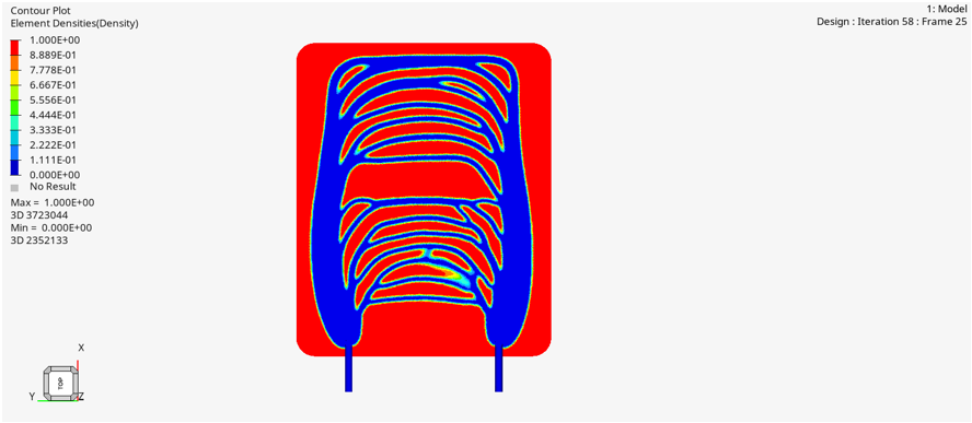

View Contour Plot
  1. Launch HyperView and open the result file.
  2. Click Contour.
    Figure 20.
  3. For Result type, select Element Densities (s) from the first pull-down menu.
    Figure 21. Element Densities Contour Plot
    Figure 22. Grid Temperature Contour Plot
