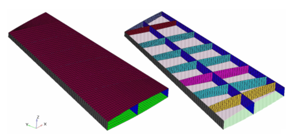

The model is already set up for the analysis. The model properties, loads, boundary conditions, and loadsteps are already defined. The model has 15 components out of which the TopSkin and BottomSkin components are defined with the composite property PCOMP. The rest of the components are defined with PSHELL property which references the material property, Aluminum.
From the 2D page, click the HyperLaminate panel.
HyperLaminate opens.
In the Laminate Browser, Laminates section, click
TopSkin.
The TopSkin component properties display in the Laminate definition and Review sections. The Laminate definition section shows the ply material, ply thickness, ply orientation, and so on, which is shown graphically under the Review section.

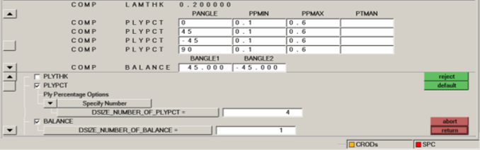

- Click edit.
- In the Card Image dialog, select PLYPCT.
- Under PLYPCT, select BYSET.
In the DSIZE_NUMBER_OF_PLYPCT= field, enter
4.
This specifies that ply percentage constraints will be defined on 4 plies. In the Card Image dialog, four additional lines appear, in which you can enter the ply percentage constraints.
- PANGLE
- Ply orientation to which the PLYPCT constraints are applied.
- PPMIN
- Minimum ply percentage thickness for the PLYPCT constraint.
- PPMAX
- Maximum ply percentage thickness for the PLYPCT constraint.
- PTMAN
- Manufacturable ply thickness.
Figure 3.
In the first COMP PLYPCT row, edit the constraints.
This defines that for each element, the thickness of the ply with ply angle 0, should be no less than 10% or more than 60% of the total thickness.
In the second COMP PLYPCT row, edit the constraints.
- For PANGLE, enter 45.
- For PPMIN, enter 0.1.
- For PPMAX, enter 0.6.
- Leave the PTMAN field blank.
In the third COMP PLYPCT row, edit the constraints.
- For PANGLE, enter -45.
- For PANGLE, enter 90.
Select BALANCE.
The BALANCE constraint ensures that two plies will always be of equal thickness.
- BALANCE
- BALANCE flag indicating that a balancing constraint is applied.
- BANGLE1
- First ply orientation to which the BALANCE constraint is applied.
- BANGLE2
- Second ply orientation to which the BALANCE constraint is applied.
In the BALANCE row, edit the constraints.
- For BANGLE1, enter 45.
- For BANGLE2, enter -45.
This defines that the plies with ply angle of 45 and -45 will always have the same thickness. - Click return to return from the panel.
- Click update to update the above defined manufacturing constraints to the free-size design variable.

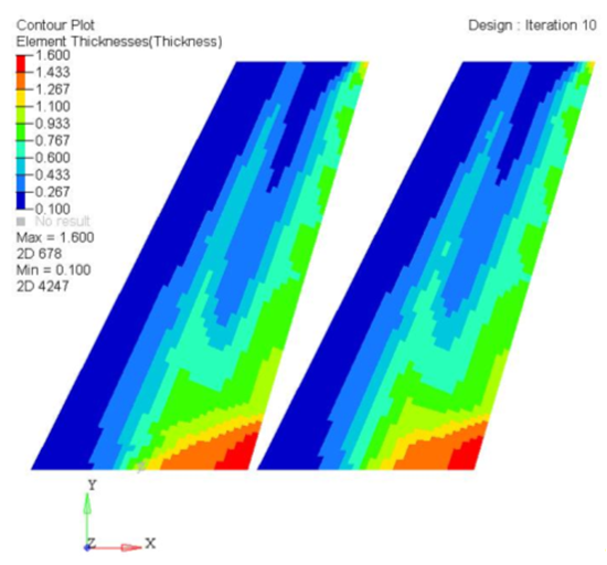

- Set the Result type to Element thicknesses and Thickness.
Click Apply.
The contour of total laminate thickness for the selected iteration displays.
In the Results Browser, select the last design iteration
result.
Figure 4.
The contoured thickness is the optimal laminate thickness distribution for the current design.

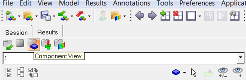

In the Results Browser, click
to activate the Component view.
Figure 5.

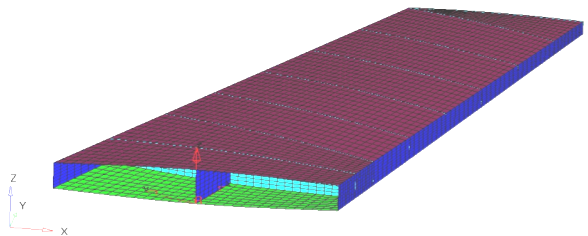

From the view controls in the Results Browser, click
(Isolate Shown) and click the BottomSkin and
TopSkin components.
The two components are isolated. -
On the Visualization toolbar, click
to open the Exploded View panel.
- Click Add to add a new explosion view.
- Click one of the components to select it for translating.
- Under Translate, set the Direction to X Axis.
- In the Distance field, enter 5.
Click + to move the selected component in the positive X
direction. Repeat until the component is moved enough to view both the
components.
Figure 6. Laminate Optimized Thickness Contour

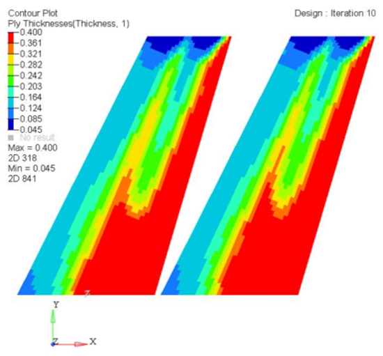

- Set the Result type to Ply Thickness and Thickness.
- Set Entity with Layer to 1.
Click Apply.
The first ply thickness contour displays. You can repeat these steps to plot the thickness for Ply 2, Ply 3, and Ply 4 or Max, and so on.
Figure 7. First Ply Optimized Thickness Contour
