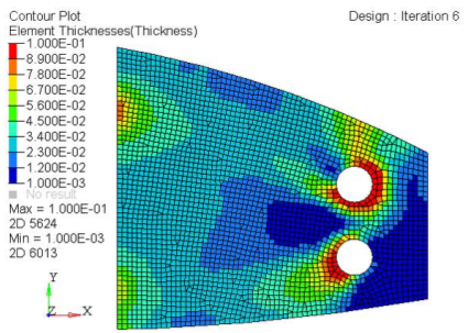

- Set the Result type to Element Thicknesses.
In the Results Browser, select the last iteration listed in
the Simulation list.
On the Standard Views toolbar, click
to show the top view of the Web.
The contour element thickness on the Web component displays.
The result from free-sizing optimization is a web with optimized thickness distribution that can be reduced subsequently into larger zones for simplification of the manufacturing process. Moreover, the design obtained from free-sizing offers the freedom to create cavities, ribs, and varying thickness simultaneously, which is not possible in topology optimization.Figure 3. Thickness contour from free-sizing nonlinear gap optimization. on the Web of plate thickness 0.1mm
