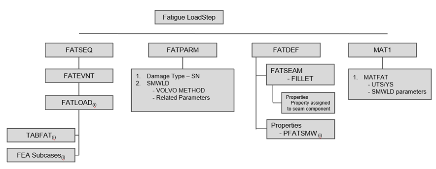

The method is a hot-spot stress approach applicable to thin metal sheets.
Hot spot stress is calculated from grid point forces at weld line. The method showed a good agreement with laboratory test results for sheet thickness between 1.0 mm and 3.0 mm. The method typically requires two SN curves. One is a bending SN curve which is dominated by bending stress, and the other is a membrane SN curve which dominated by membrane stress.
- Modeling seam welds uses a CQUAD4 element formulation.
- “Volvo Method” or “Hot Spot” Stress approach is used to calculate the hot spot stress from the nodal force at weld line.
- Force equilibrium at weld line holds true regardless of weld shape.
- Launch Fatigue Process Manager
- Import a model
- Create fatigue subcase
- Define fatigue analysis parameters
- Define fatigue elements and SN properties
- Define load-time history and loading sequence
- Submit the job
- View results summary and launch HyperView for post-processing

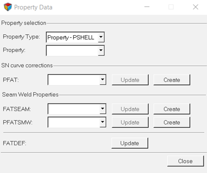

Define Properties
Click Add Property.
A Property Data window opens.
For Property Type, select Property-PSHELL.
Figure 5. Fatigue Property Data
- Click Close.

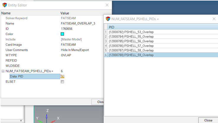

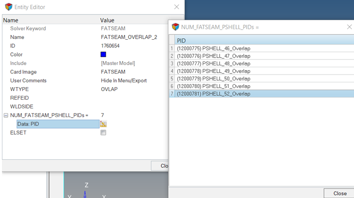

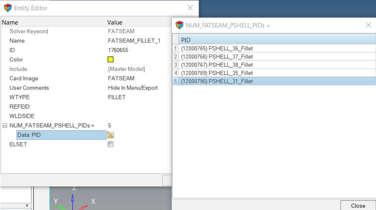

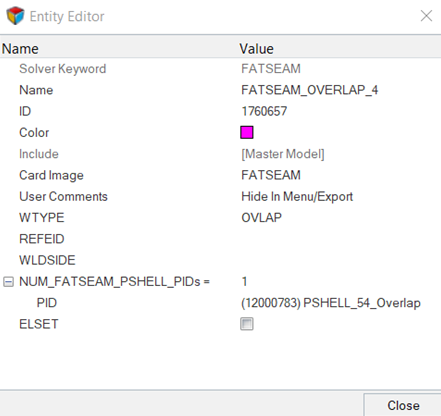

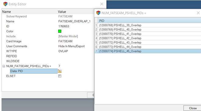

Define FATSEAM Load Collector
FATSEAM helps to select the seam weld type.
In this case it is the fillet weld.
- In the Model Browser, right-click and select .
- For Name, enter FATSEAM_OVRLAP_1.
- For Card Image, select FATSEAM.
- Set WTYPE to OVLAP.
- Set NUM_FATSEAM_PSHELL_PIDS to 7.
Click the table icon
next to
Data: PID and select 7
different PSHELL IDs for all the 7 PID rows in the table, in the pop-out window.
- Click Close twice to close the table dialog, as well as FATSEAM dialog.
Follow the steps above to create 4 more FATSEAM cards, as
shown in the images below. The FATSEAM cards can be named as: FATSEAM_OVERLAP_2,
FATSEAM_FILLET_1, FATSEAM_OVERLAP_3 and FATSEAM_OVERLAP_4
Note: Confirm WTYPE is set to FILLET when defining the FATSEAM_FILLET_1 card.
Figure 6. FATSEAM (FATSEAM_OVERLAP_1) Definition
Figure 7. FATSEAM (FATSEAM_OVERLAP_2) Definition
Figure 8. FATSEAM (FATSEAM_FILLET_1) Definition
Figure 9. FATSEAM (FATSEAM_OVERLAP_3) Definition
Figure 10. FATSEAM (FATSEAM_OVERLAP_4) Definition

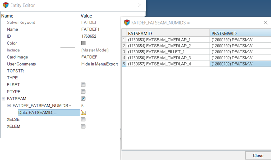

Update FATDEF Cards
Click Update next to FATDEF.
The FATDEF Entity Editor dialog opens.
- Verify that the FATSEAM option is checked and FATDEF_FATSEAM_NUMIDS= field is set to 5.
next to Data: FATSEAMID and from property selector,
select the property PFATSMW for all FATSEAMID, as shown
below.
Figure 11. FATDEF Dialog
- Click Close to close the FATDEF dialog.
- Click Close button to close the Property Data dialog.

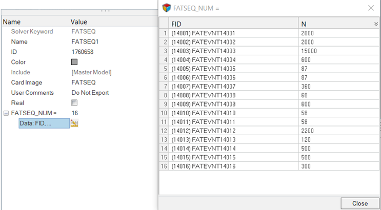

Define FATSEQ Load Collector
It is required to update the FATSEQ card with number of repetitions (N#) for each fatigue event created.
- Open the exported Solver deck in a text editor, or
- Import it back into HyperMesh
When updating the FATSEQ card in an HyperMesh session, follow the below steps.
- In a new session, import the OptiStruct Solver deck (exported in previous step) by selecting Include files set to “Merge”.
In the Model Browser, expand Load
Collector and select the FATSEQ1 card.
The Entity Editor opens.
next to Data: FID and enter appropriate Repeat value N
for all fatigue events, as shown below.
Figure 13. FATSEQ Card Update Dialog

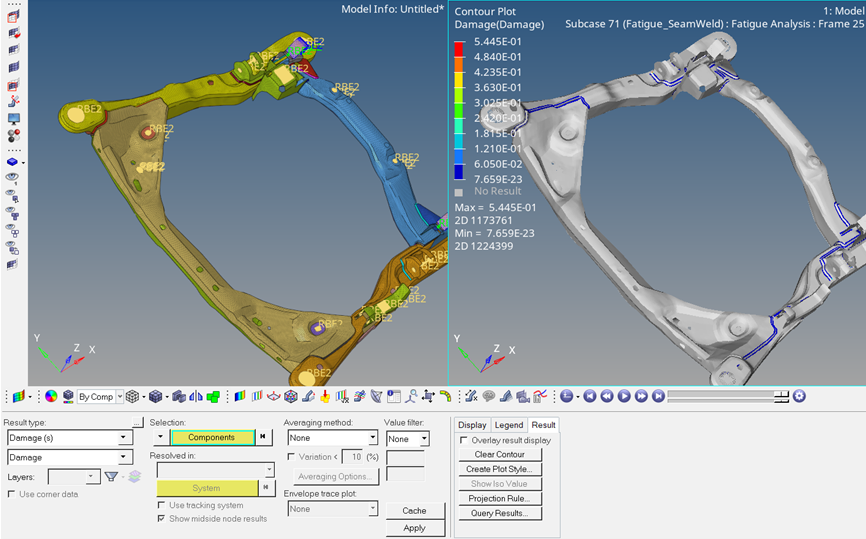

Post-Process
Once the job is completed successfully, check the directory to make sure the .out and .h3d files are available.
- Load the results file (.h3d) into HyperView to post-process.
- Select Subcase 71 (Fatigue_SeamWeld) from the subcase dropdown.
- Go to the Contour panel and select Damage result type.
Click Apply.
Figure 14. Damage Contour in HyperView
