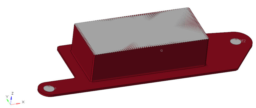

The model being used for this exercise is that of a simple CAD box (Figure 1). Four loadsteps have already been defined on this model, each of which represent Normal Modes Analysis, Frequency Response at both the constraint points and the Random Response Analysis.

Import the Model
Click .
An Import tab is added to your tab menu.
- For the File type, select OptiStruct.
Select the Files icon
A Select OptiStruct file browser opens. - Select the CAD-box-SN.fem file you saved to your working directory.
- Click Open.
Click Import, then click Close to
close the Import tab.

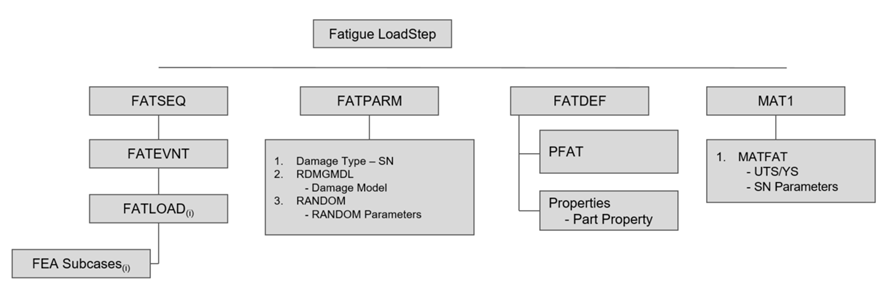

The outline of the Fatigue Analysis setup to be achieved in the following steps.
Figure 2. Fatigue Setup - Random SN Damage

Define the Fatigue Load Step
- In the Model Browser, right-click and select .
- For Name, enter Vibration_Fatigue.
- Set the Analysis type to fatigue.
- For FATDEF, select fatdef.
- For FATPARM, select fatparam.
- For FATSEQ, select fatseq.

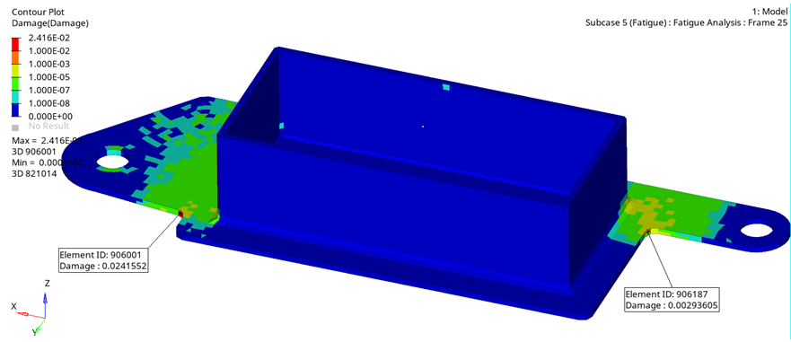

Review the Results
From the OptiStruct panel, click HyperView.
HyperView is launched and the results are loaded. A message window appears to inform of the successful model and result files loading into HyperView.
- Go to the Results tab.
- In the Results tab, select Subcase 5 (Vibration_Fatigue) from the subcase field.
On the Results toolbar, click
to open the
Contour panel.
Set Result type to Damage and click on
Apply to contour the elements.
Figure 5. Damage Contour Plot
