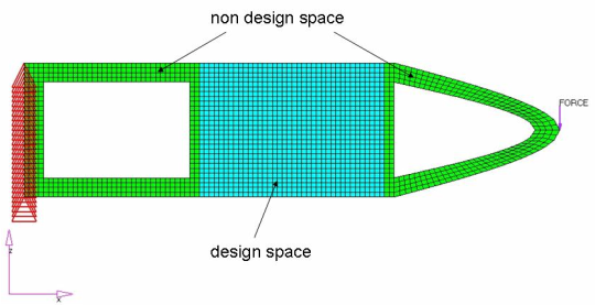

In this tutorial an existing finite element model of a simple cantilever beam is used to demonstrate how to reduce the finite element model using static reduction. You will also perform a topology optimization on the reduced model.
- Objective
- Minimize compliance.
- Constraints
- Upper bound constraint of 40% for the designable volume.
- Design Variables
- The density for each element in the design space.

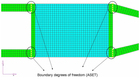

The part to be reduced out of the model through the static reduction model reduction technique is referred to as a superelement. In OptiStruct, ASET or ASET1 Bulk Data Entries are required to indicate the boundary degrees of freedom of a superelement, meaning the set of degrees-of-freedom where the component (being replaced by direct matrix input) connects to the modeled structure. Both the accuracy and the cost of static reduction increase as the number of ASET entries is increased. For example, by using static reduction, the size of the matrix to solve will become smaller, but if the reduced matrix (DMIG) is very dense, then the solution time will become larger than the solution time for the full model where the matrix may be sparse. Hence, the selection of ASET entries is very important in performing an efficient analysis using DMIG.

Create ASETs Load Collector
Create a load collector.
Create constraints.

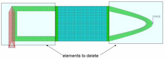

Delete Elements Retained in the Subsequent Optimization
- Press F2 to open the Delete panel.
- Set the entity selector to elems, then click .
Draw a window around the elements indicated in Figure 5.
Figure 5.
- Click delete entity.
- Click return to go to the main menu.

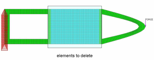

The cantilever_full.hm database is loaded into the current HyperMesh session, replacing any existing data.
Delete Superelement Part Reduced out using DMIG
Draw a window around the elements indicated in Figure 7.
Figure 7.

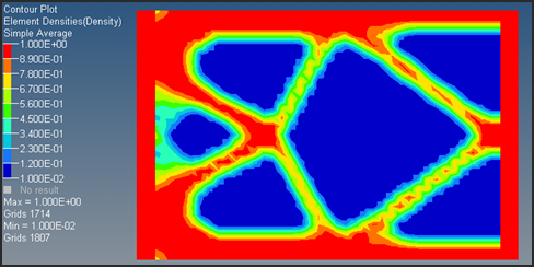

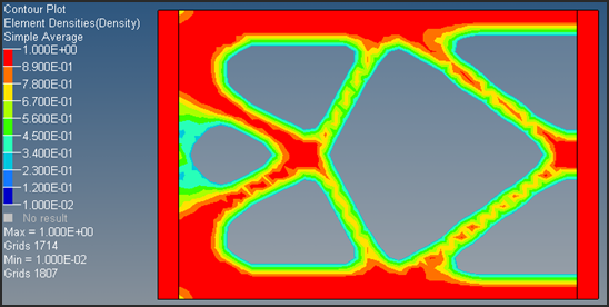

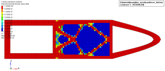

View the Results
Element density results are output to the cantilever_opti_des.h3d file from OptiStruct for all iterations. In addition, Displacement and Stress results are output for each subcase for the first and last iterations by default into cantilever_opti_s#.h3d files, where # specifies the sub case ID.
Review the Contour Plot of the Density Results
- From the OptiStruct panel, click HyperView.
From the Results toolbar, click
to open the Contour panel.
- Set the Result type to Element Densities[s] and Density.
- Set the Averaging method to Simple.
- Click Apply to display the density contour.
On the Animation toolbar, click
to choose the last iteration from the
Simulation list.
View an Iso Value Plot of Element Densities
to open the Iso Value panel.
- Set the Result type to Element Densities.
- Set Show values to Above.
- Click Apply.
- Under Clipped geometry, select Features and Transparent.
Change the density threshold.
- In the Current value field, enter 0.3.
- Under Current value, move the slider.
When you update the density threshold, the Iso value displayed in the modeling window updates interactively. Use this tool to get a better look at the material layout and the load paths from OptiStruct.
