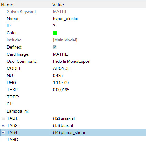

Create the Material
- In the Model Browser, right-click and select from the context menu.
For Name, enter hyper_elastic.
A new material, hyper_elastic has beeen created.
- For Card Image, select MATHE.
- For MODEL, select ABOYCE.
Enter the material values next to the corresponding fields.
- For NU (Poisson's Ratio), enter 0.495.
- For RHO, enter 1.11e-9.
- For TEXP, enter 0.000165.
Figure 2. Define hyperelastic material
- Click TAB1 and assign Tension-Compression uniaxial.
- Click TAB2 and assign Equi-Biaxial Tension biaxial.
- Click TAB4 and assign Pure Shear planar_shear.

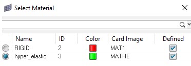

- For Material, click .
In the Select Material dialog, select
hyper_elastic and click
OK.
Figure 3. Select material hyper_elastic for the -roperty

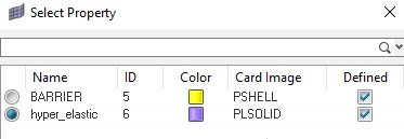

- For Property, click .
In the Select Property dialog, select
OK.

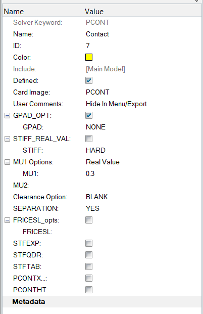

Create Properties for Contact Parameters
In this step, the properties for both surface to surface and self-contact surfaces will be defined.
- For Name, enter Contact.
- For Card Image, select PCONT.
- Activate GPAD_OPT and for GPAD, select NONE from the drop-down menu.
- For STIFF, select HARD.
For MU1, enter 0.3.
Figure 5. Property values for Contact

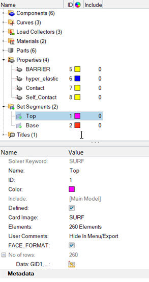

Create Set Segments
The set segments will be defined, which will be used later to define the contact groups.
- For Name, enter Top.
- Right-click on the component Top and select Isolate Only.
Click Entity IDs to select the elements corresponding to
Top.
Note: Make sure to switch the selection panel from faces to elements.

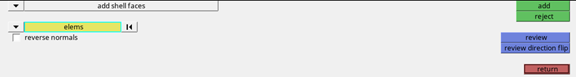

Click elems.
The selection panel opens.
- Select add shell faces from the drop-down menu,
- From the second drop-down, select elems as shown below.
Click
.This selects all the elements corresponding to the component Top.
Figure 6. Elements selection panel
This creates a Top set segment with elements corresponding to the
Top.
Figure 7. Create Top set segment
Similarly, create a set segment for the component
Base.
Note: Make sure to select FACE_FORMAT, while creating the set segment for Top and Base.

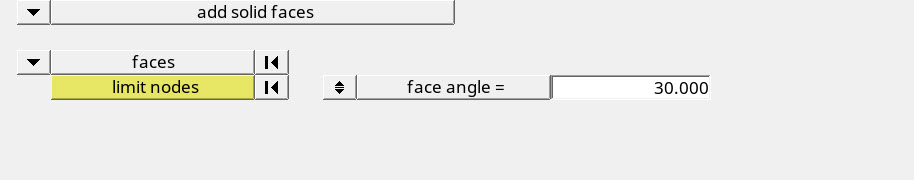

- To create a contact set segment for the inner and outer surface of the wheel, right-click on the component Wheel, select Isolate Only.
- For Name, enter rubber_inner.
Set the selection panel to add solid faces.
Figure 8. Create rubber_inner contact set segment
Select the inner surface of the wheel to select the elements contributing to
the Rubber_inner set segment.
Figure 9. Select rubber_inner contact set segment
- Similarly, create a contact set segment Rubber_outer by selecting the outer face of the component Wheel.

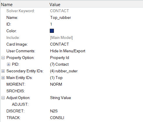

- For Name, enter Top_rubber.
- For Card Image, select CONTACT.
- For Property Option, select Property Id.
Expand PID and select Contact
surfaces.
Figure 10. Create a Contact Group
- For Secondary Entity IDs, select rubber_outer.
- For Main Entity IDs, select Top.
- For MORIENT (Contact Orientation), select NORM.
- For DISCR, select N2S (Node to Surface).
- For TRACK, select CONSLI.

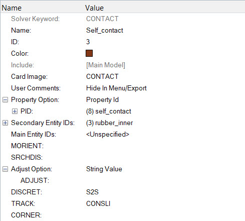

- Now, create a contact group Self_contact and select the Card image to CONTACT.
- For Property Id, assign the self_contact property created previously, as shown in Figure 11.
- Select the set segment created earlier for the Rubber_inner as the Secondary Entity IDs.
For DISCRET, select S2S (Surface to Surface).
Figure 11. Create a self_contact Group

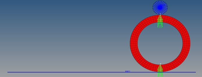

Apply Loads and Boundary Conditions
In the following steps, you will apply the boundary conditions and prescribed displacement on the model.
Create SPC Load Collector
A default load collector displays in the Entity Editor.

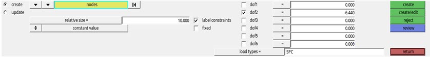

- For Name, enter spc_top1.

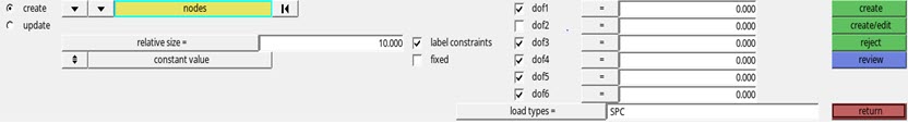

- Click to open the Constraints panel.
- Select the node 2269 corresponding to the Top component.
Constrain the node in 1, 3,
4, 5, and
6 directions.
Assigns the boundary conditions for the first load step (Compression).
Figure 12. Constrain Node 2269
Click create.
This applies the constraints to the selected nodes.
Constrain the dof2, enter -6.44.
Assigned a displacement of magnitude in the negative y-direction.
Figure 13. Apply Displacement to the Node 2269 Corresponding to First Load Step

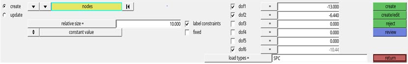

- For Name, enter spc_top2.
- Apply the constrains in the dof's 3, 4, and 5.
For dof1, enter -13.0.
Applies a displacement of magnitude in the negative x-direction.
For dof2, enter -6.44.
Applies a displacement of magnitude in the negative y-direction corresponding to the x and y displacement of the ring.
For dof6, enter -10.44.
Applies a rotation in the x-z plane.
Figure 14. Apply Displacement to the Node 2269 Corresponding to the Second Load Step

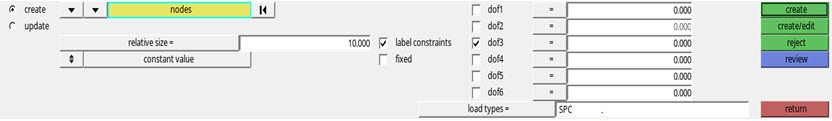

Click nodes and from the panel, select
displayed and constrain
dof3.
Figure 15. Apply Constraints to the Wheel

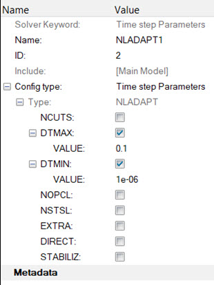

Create NLADAPT Load Step Input
- In the Model Browser, right-click and select .
- For Name, enter NLADAPT1.
- For Config type, select Time step Parameters.
- For Type, the default is NLADAPT.
- For DTMAX, enter 0.1.
For DTMIN, enter 1e-6.
Figure 18. Create NLADAPT load step input

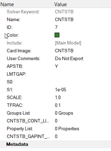

Create CNTSTB Load Collector
- For Name, enter CNTSTB.
- For SI, enter 1e-5
- For SCALE, enter 1.
For TFRAC, enter 0.1.
Figure 19. Create a CNTSTB Card

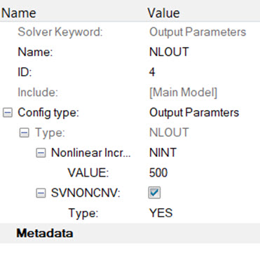

Create NLOUT Load Step Input
- For Name, enter NLOUT.
- For Config type, select Output Parameters.
- For Type, the default is NLOUT.
- For NINT, enter 500.
Activate SVNONCNV.
Figure 20. Create NLOUT Card

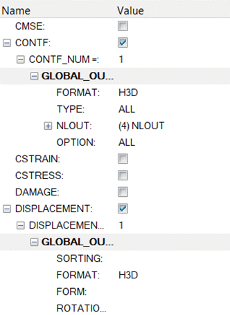

Define Output Control Parameters
Below DISPLACEMENT, ELFORCE, STRESS and CONTF, set Option to
Yes.
Figure 21.

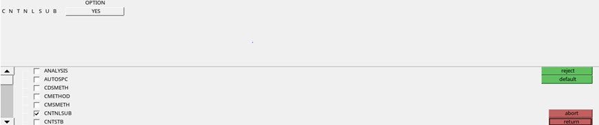

Activate GLOBAL_CASE_CONTROL
- From the Analysis page, select control cards.
For control cards, select CNTNLSUB and select
YES.
Figure 23. Create Global Case Control

- Similarly, select the NLPARM, NLADAPT2, NLOUT, and CNTSTB and assign respective load step inputs and load collectors.

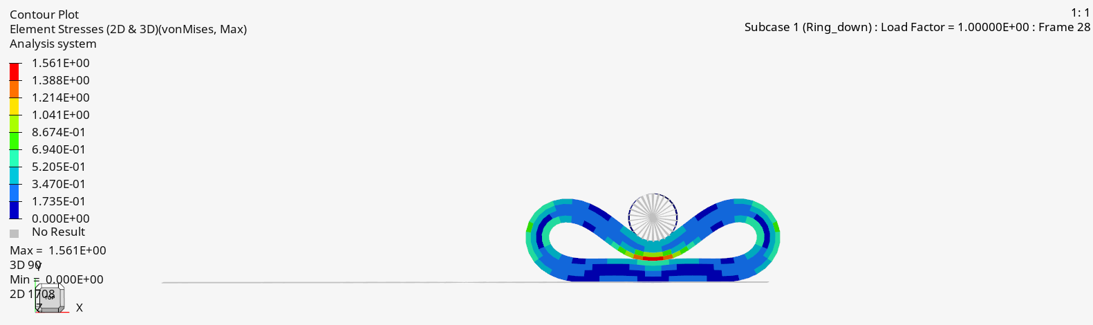

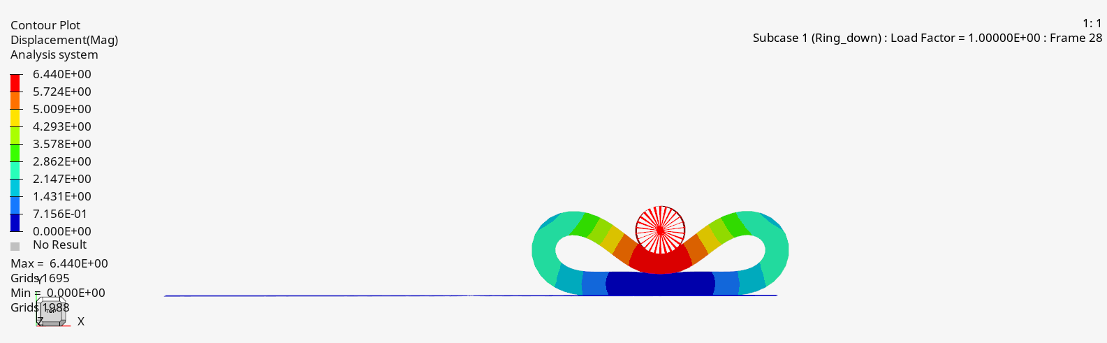

- Once you receive the message Process completed successfully in the command window, click HyperView.
- Open the results and plot the displacement and the von Mises stress contour at 100% load.
On the toolbar, click
(Contour).
- Under Result type, from the first drop-down menu, select Element Stresses (2D & 3D)(t).
Under Result type, from the second drop-down menu, select
vonMises.
Figure 25. Contour Panel
- Verify that the fields in the Contour panel match those in Figure 25 and click Apply.
Similarly, in the menu below Result type, select
Displacement from the first drop-down menu and
Mag from the second drop-down menu.
Figure 26. Displacement Result for First Load Step
Figure 27. Stress Result for First Load Step

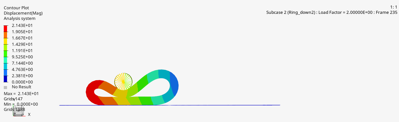

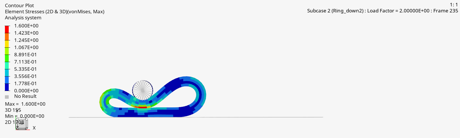

Figure 28. Displacement Result for Second Load Step
Figure 29. Stress Result for Second Load Step
