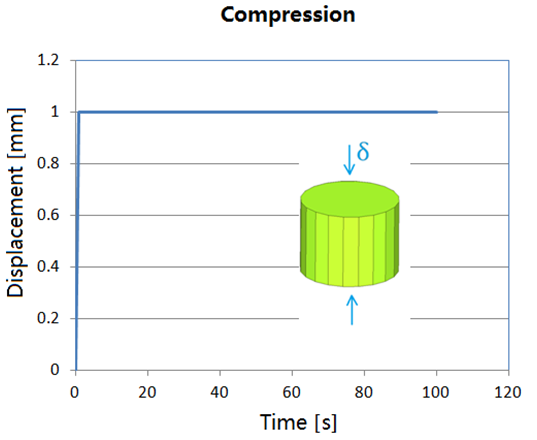

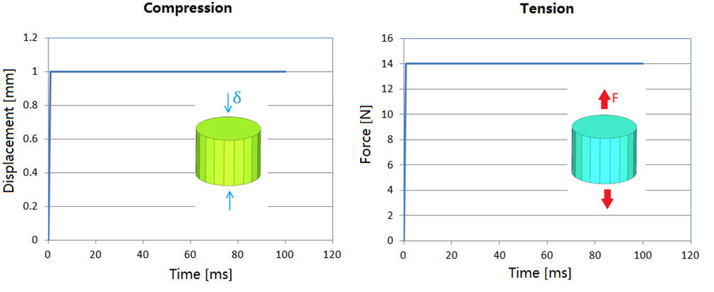

- For stress relaxation test: The foam sample has been compressed until a given strain and kept in this state.

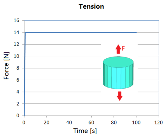

- For creep test: The foam sample has been tensile under constant force.

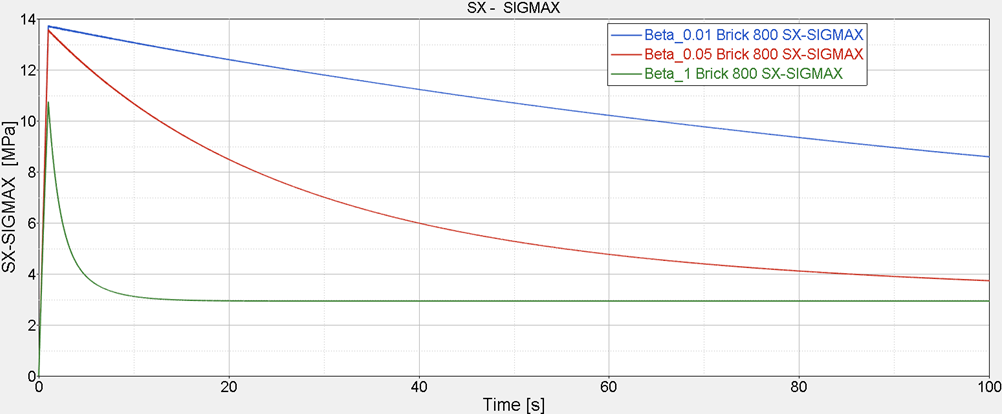

For stress relaxation test: The foam sample has been compressed under constant displacement (/IMPDISP).
For creep test: The foam sample has been tensile under constant force (/CLOAD).
Results

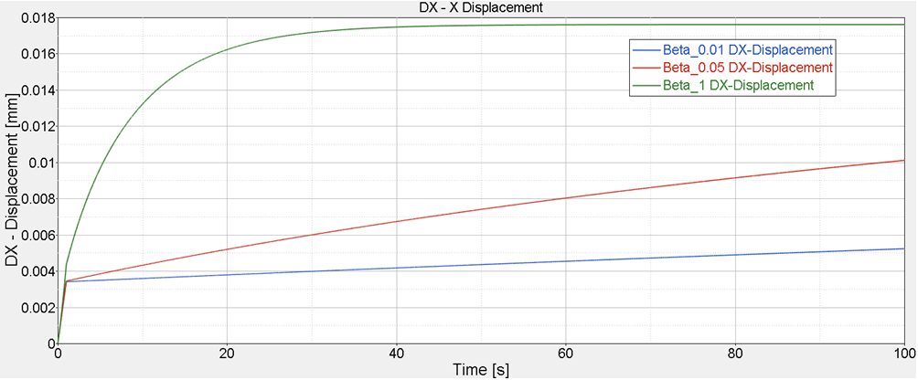

In LAW40 shear modulus is reduced with time and tends to G∞ after an infinite period of time. The softening speed is determined by relaxation parameter . Higher relaxation parameter means quick softening.
with

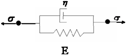

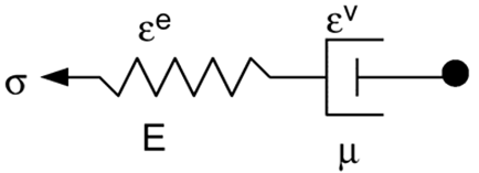

The general case of viscous materials represents time-dependent in elastic behavior. Creep is time-depended deformation and stress relaxation is a time-depended decrease in stress. Viscous material can describe these two phenomenons. In Radioss, the following material laws describe viscous:
