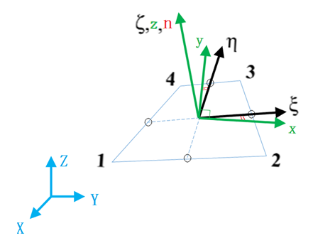

Figure 1. 4-Node Shell Element
( X , Y , and Z ) - Global Cartesian fixed system:
( ξ,η,ζ ) - Natural system (non-normalized coordinate system).
  • ξ is from middle point of Line 14 to middle point of Line 23.
  • η is from middle point of Line 12 to middle point of Line 34.
  • Plane ( ξ , η ) is in the middle surface of shell element and ζ is normal of the middle surface.
( x , y , and z ) - Local coordinate system (orthogonal, normalized elemental coordinate system):
  • z is normal of middle surface.
  • ( x and y ) are in the middle surface
  • x and y are positioned so that they have same angle between x and ξ , y and η
The origin of ( ξ , η , ζ ) and ( x , y , and z ) are the same as it is at the intersection point of middle point line.

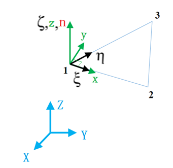

3-node Shell Element
  • ξ is from Node 1 to Node 2.
  • η is from Node 1 to Node 3.
( x , y , and z ) - Local coordinate system (orthogonal, normalized elemental coordinate system).
  • x is from Node 1 to Node 2.
  • y is orthogonal to x and ( x and y ) are in the middle surface.
The origin of ( ξ , η , ζ ) and ( x , y , and z ) are the same as it is at Node 1.

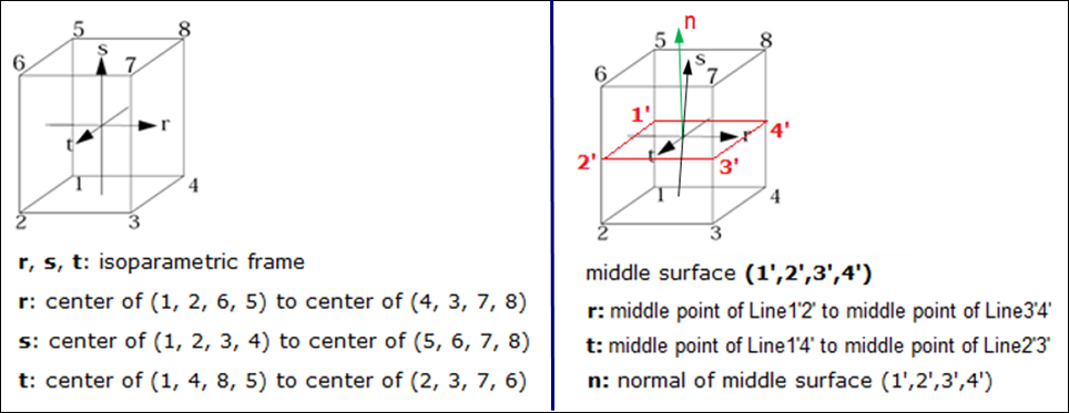

Solids and Thick Shells (hexa)
  • Global system ( X , Y , and Z )
  • Natural system ( r , s , and t )
  • Local element coordinate system ( x , y , and z )
  • Material system
Figure 3. Solids and Thick Shells (hexa)
( r , s , and t ) - Natural system (non-normalized coordinate system).
  • r is from the center of surface (1, 2, 6, and 5) to center of surface (4, 3, 7, and 8)
  • s is from the center of surface (1, 2, 3, and 4) to center of surface (5, 6, 7, and 8)
  • t is from the center of surface (1, 4, 8, and 5) to center of surface (2, 3, 7, and 6)
Plane ( r , t ) is also in the middle surface (1', 2', 3', and 4').
  • r is also from middle point of Line 1' and 2' to middle point of Line 3' and 4'.
  • t is also from middle point of Line 1' and 2' to middle point of Line 3' and 4'
  • n is normal of middle surface (1', 2', 3', and 4')
Local coordinate system in middle surface (1', 2', 3', and 4') is the same as the local coordinate system in middle surface (1, 2, 3, and 4) for shell element. r in solid is the same as ξ in shell element.

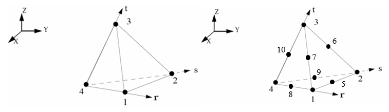

Tetra Elements
  • r is from node 4 to node 1
  • s is from node 4 to node 2
  • t is from node 4 to node 3
Figure 4. Tetra Elements
