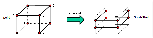

The elements HA8, HEPH and
BRICK20 can be transformed to solid-shell elements by setting
constant the normal stress through the thickness.
This assumption allows obtaining solid elements suitable for thick-shell modeling, where only one
element through a thickness can be used. In additional to these elements,
SHELL16, PA6 and other solid-shell
elements are available.Figure 1. Solid versus Solid-Shell

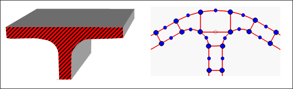

Solid-shell elements, especially SHELL16 can be useful to model thick shell
structures with massive junctions (Figure 2). The time
step proportion to the shortest distance between two nodes can be small depending on
the thickness and material characteristics.Figure 2. Application of Solid-Shell Elements
