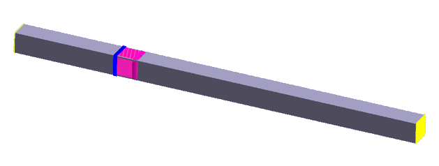

Bar was modeled as a 3D solid with immovable ends. Axial force F could not be applied precisely at the solid bar axis, so four line spots were created at the bar sides and total load F was uniformly distributed over the spots (Figure 3).
Figure 3.
The following table summarizes the reaction force results.
Force F [N] SOL Reference, Reaction [N] SimSolid, Reaction [N] % Difference
30000 17128 17635 2.96%
47000 26834 26993 0.59%
55000 31401 31694 0.93%
60000 34256 34546 0.85%
