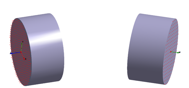

Grounded bushing with above referenced stiffnesses is applied on one end of the
cylinder and a remote load of 10 N-m about the cylinder axis is applied on the other
end, as shown in Figure 2.Figure 2.
Datum points are created along the circumference of the cylinder. Rotation between
the points is measured to calculate the rotation of the cylinder due to applied
moment load.Figure 3.
