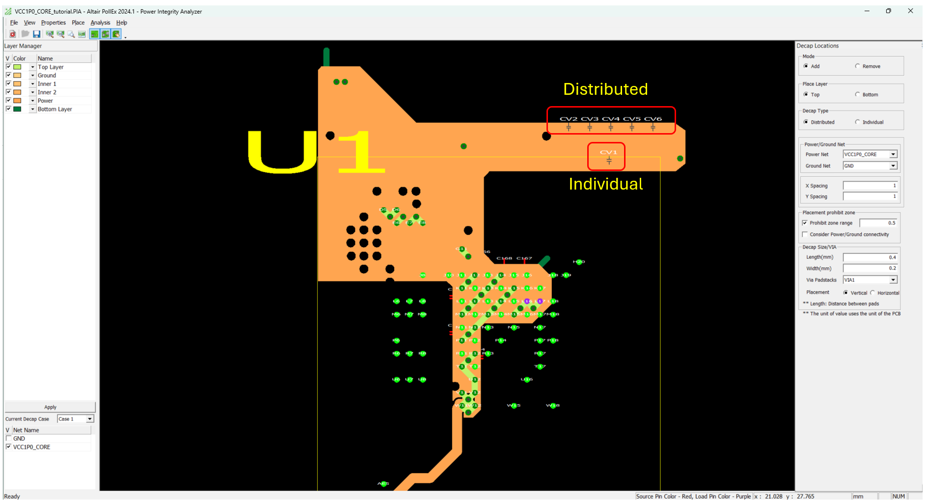

Decap Type Options
- Individual: You can add one capacitor near Load component. The default name of Individual capacitor is adding CV character. (For example, CV1)
- Distributed: You can add distributed (multiple) capacitors to any location. The distance between the distributed capacitors can be controlled with X Spacing and Y Spacing options. The default names of distributed capacitors are also added to the CV character. (For example, CV2~CV6)
- Place prohibit zone : This function establishes a designed range of distance from the center of the Via where the decap component is not allowed to be positioned, thus preventing any overlap between the decap and Via. (for example, prohibit zone range 0.5mm)
- Decap Size/VIA : In Decap Size/VIA, you can set the size and orientation
(Vertical, Horizontal) of the Decap, and configure the VIA Padstack.

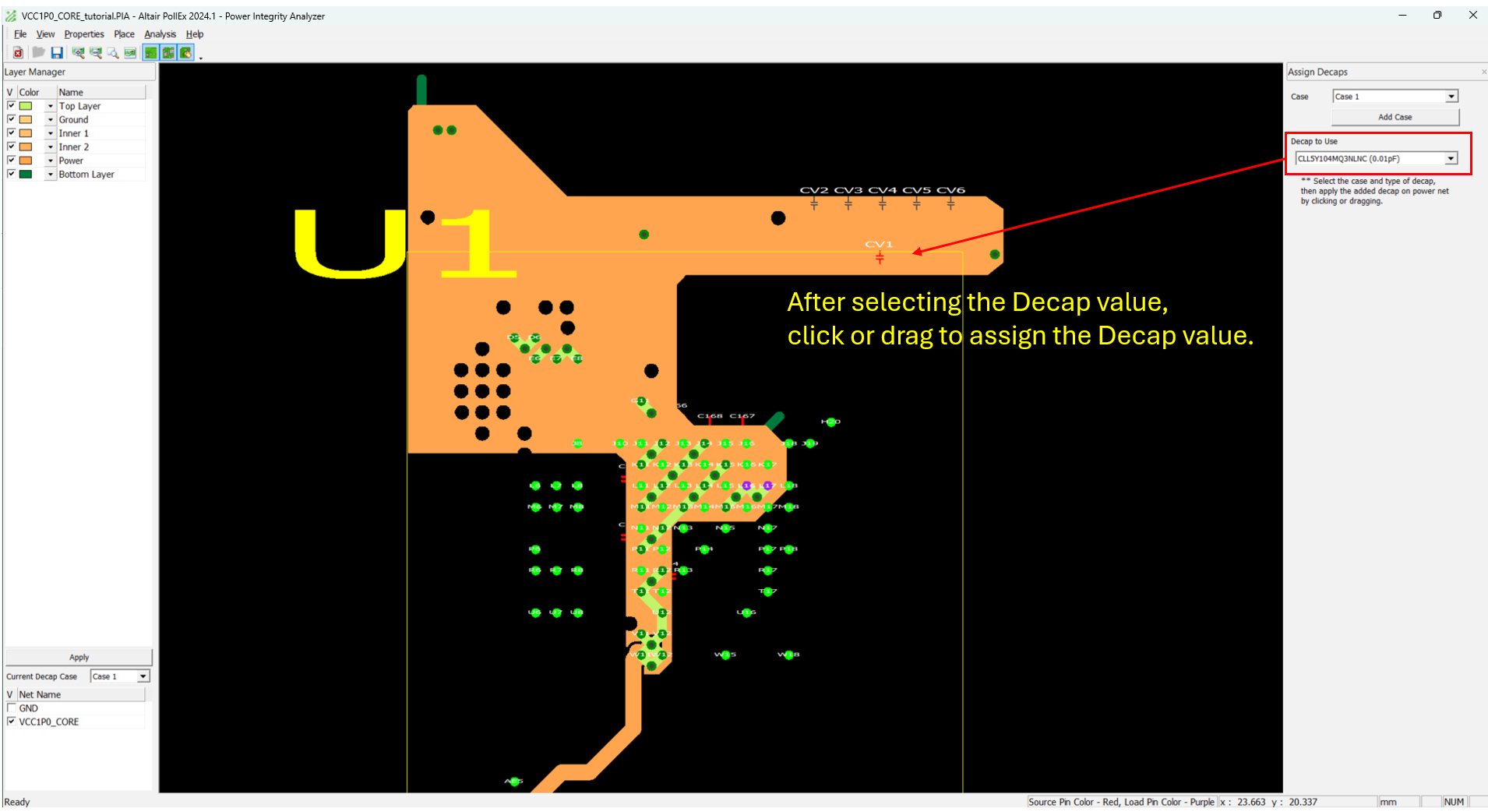

The default color of newly added capacitors are gray, gray color means that this capacitor has been positioned but no value has been assigned. The color of the capacitor changes to red after a capacitance value is assigned.
You can assign different values for each test case for the capacitor at the same location.
- Case: Change current test case. The capacitor value is assigned to the currently selected test case.
- Add Case: Add new test case.
- Decap to Use: Select the required capacitor value to be assigned.
- To assign values to the Decap, simply click or drag the
corresponding Decap on the left screen.
