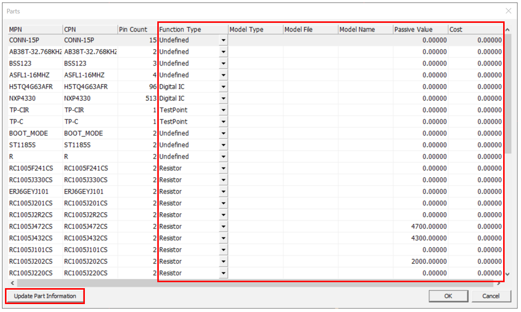

View part property assignment.

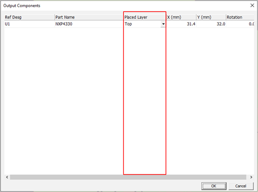

Select to view receiver component information.
You can edit the Placed Layer from this dialog.

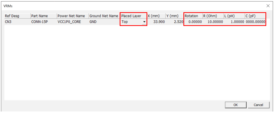

Select to view power source component information.
You can edit the Placed Layer and also RLC values from this dialog.
Figure 3.

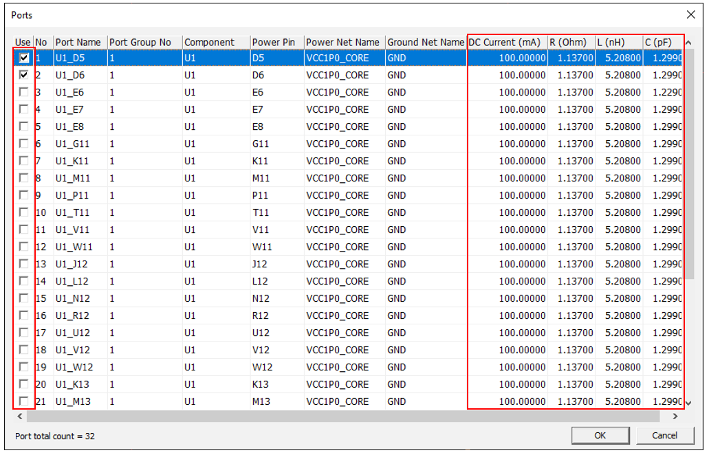

Select to view power load component information.
You can :
- choose each port you want to use on this dialog
- edit the DC Current (mA) for DC IR-Drop analysis from this dialog
- edit the R (ohm), L(nH) and C(pF) value for each ports
Figure 4.

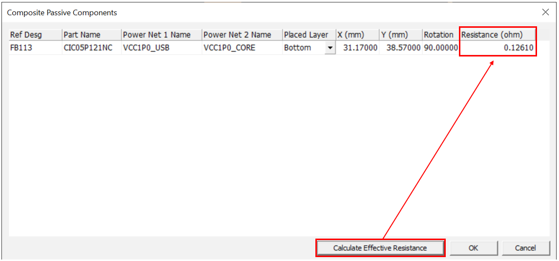

Select to view composite passive components connected to the selected
power net (Exclude Capacitors).
You can calculate Effective Resistance if there is composite passive component which is importing S-parameter data from this dialog.
Figure 5.
