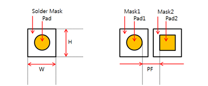

Board Figure Geometries: Set the size of the target objects. Use if
the fiducial mark is defined with a solder-mask and/or pad.
Mask1(S/R) Size (SS): Set the fiducial mark with the outer
mask size.
PAD1 Size (PS): Set the fiducial mark with the inner pad
size.
Mask2(S/R) Size (SS): Set the fiducial mark with the outer
mask size.
PAD2 Size (SS): Set the fiducial mark with the inner pad
size.
Mask/PAD Distance (PF): Set the fiducial mark with the
distance between the pads.Figure 1.

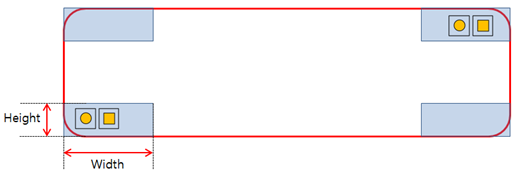

Fiducial Mark Searching Ranges from Board Corner & Layer: Set
the area where the fiducial mark is located from the board corner.
Use PollEx DFM to search the given area to
find the fiducial mark.
Searching Ranges: Set the width and height of the fiducial
mark search ranges starting from the specified board
corner.Figure 2.

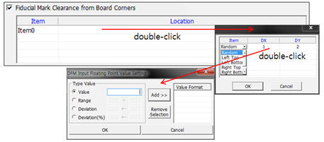

Fiducial Mark Clearance from Board Corners: Verify that the fiducial
marks are placed in the proper position. Define a suitable area for
placement from the board edge corners.Figure 3. Set the fiducial mark clearance value from each of the board
outline corners using the Floating Value Range Input tool.Figure 4.

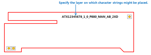

Fiducial Mark Existence Checking using Revision Number: Use the revision
number on the design to denote the location of the fiducial mark. Define
them using several settings. Three rules can be used:
Verify that a specified character string is on a specified
layer.
Verify that the revision name is matching with the given character
string and the design file name.
Verify the locations of fiducial marks using the revision
number.Figure 5.
Layer Selection: Define the layer from the artwork layer list, then
use PollEx DFM to verify that it contains
character string data.
Delimiter: Divide string into several parts. In the example below,
if the delimiter is, _ , there may be seven parts.

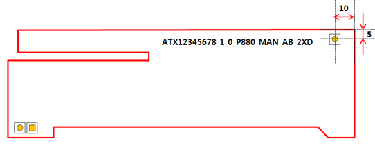

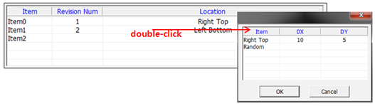

Revision Index Table: Use this table to define the fiducial mark
location depending on the revision number.Figure 7. If the revision number is 1 in the table, the fiducial mark
should be on location 10 and 5 apart from the top right corner of
the board.Figure 8.
Remainder: Set all the unspecified revision number locations.
