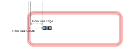

- PCB’s Outline: Select the measuring base for verifying the distance from the
board outline.
- From Line Edge
- From Line Center

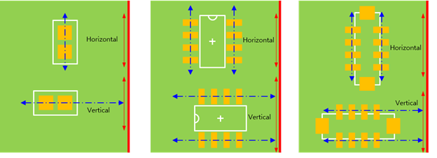

- Horizontal Clearance: Set the horizontal clearance value between the PCB outline segment and specified components.
- Vertical Clearance: Set the vertical clearance value between

- Horizontal/Vertical Clearance to Remainder Components: Set the
horizontal and vertical clearance value for the undefined components
in the table in Component Groups & Clearance.
Figure 3.

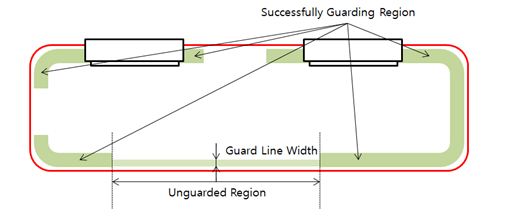

- Guard Silk Screen Width Checking: Verify the clearance between the board
outline and the guard silkscreen.
Figure 4.
- Target Layer: Select the target layer where the guard silkscreen should be designed.
- Minimum Guarding Ratio (%): Select the minimum guarding ratio
regarding the board outline.
- Minimum Silkscreen Width: Set the minimum silkscreen width to accept as the guard silkscreen.
- Components Compulsory Include into Guard Area: Set the region occupied by specified components like connectors to accept as the guarding area.
from the board outline. Select a method between From Line Edge or
From Line Center.
Figure 5.
