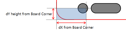

- Guide Hole Searching Ranges from Board Corner: Set the area where the
guiding hole is located. Specify area values with dX and dY from the board
corners. Refer to Figure 4.
Figure 4. Guide Hole Searching Ranges from the Board Corner

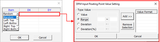

- Circle Type Guide Hole Checking
- Circle Guide Hole Counting: Verify the number of circle type guide
holes at specified regions.
Figure 5.

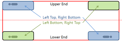

- Number of Total Guide Hole: Verify the number of guide holes.
- Counting: Verify the number of guide holes in the upper and lower side of the PCB.
- Diagonal Counting: Verify the number of guide holes in the
diagonal sides.
- Left Top, Right Bottom: Set the number of guide holes in these regions.
- Right Top, Left Bottom: Set the number of guide holes in these regions.

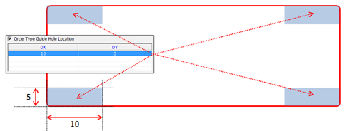

- Circle Type Guide Hole Location: Verify the guide holes in each
board corner. The table rows each correspond with the four corners
of the PCB.
Figure 6.

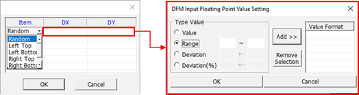

- Ellipse Type Guide Hole Location: Verify there are guide holes in
each corner. The table rows each correspond with the four corners of
the PCB.
Figure 9.
Figure 10.

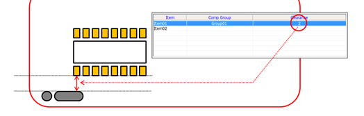

- Clearance between Guide Hole and Components
- Clearance Table: Set and assign a clearance value for the component
group. Use PollEx DFM to verify the
clearance between the component outline and the guide hole edge.
Figure 11. Clearance Table Example
- Remainder: Assign a clearance value for the undefined components in the table.
