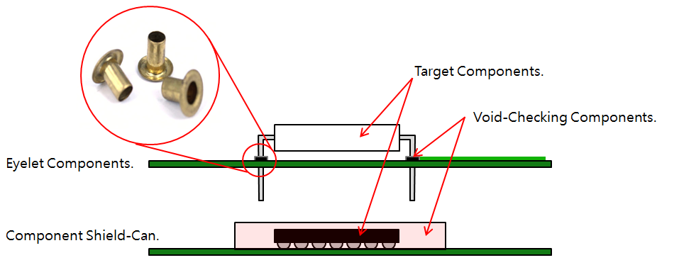

- Void-Checking Component Group: Select void-checking components with
selecting components group list. Void-Checking components would be
eyelet components or heatsink.
- Distance from void-checking Comp: For patterns connected to void-checking components within given distance from void-checking components, PollEx DFM skips to check them.
