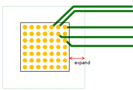

- Expand: Give the expanding value for component boundary.
- Measure Type: Select component boundary criteria among Component Overlap Check Area( COC), Silk, Silk+Pad, Pad, COC+Pad, and Measure Base (defined in component classification dialog).
