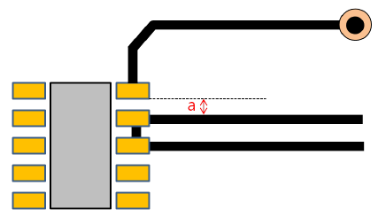

To Routing Patterns: Set the clearance value between board
figure via and routing pattern.Figure 1.

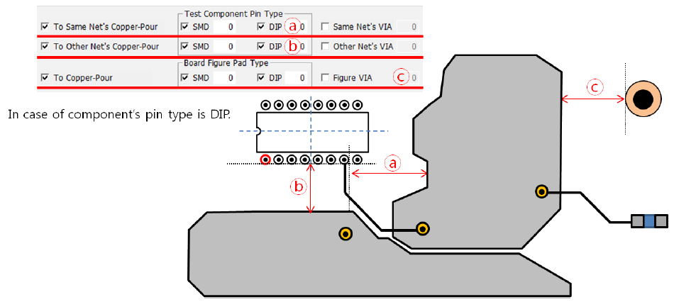

To Copper-Pour: Set the clearance value between board figure
via and copper-pour.Figure 2.

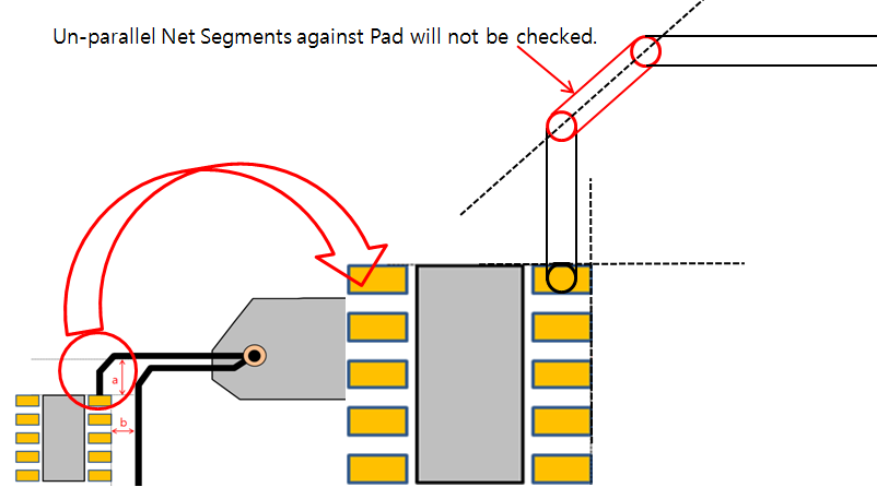

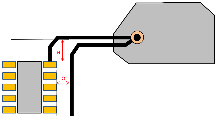

In Same Net Checking, do not check for Pad Connected Net’s Segment:
This option is a void-checking option. If you run this option,
PollEx DFM does not check the same net
pad connected net segment. Figure 3. In Figure 3, even though the result of measuring a and b
violate the input condition, in a case, the net segment is directly
connected to pad. So, only the b case will be fail. Checking target
net segments will be parallel along pads side directions.Figure 4.

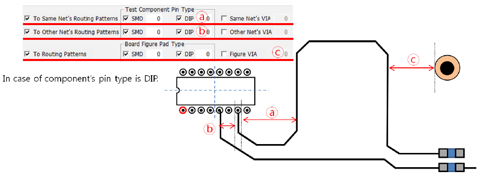

Do not check Net Segments under Pad Area: This is also a
void-checking option for net segments passing through under pad
area.Figure 5.
In Figure 5, checking a violates input condition. However,
because the violating net segment is lying under the pad area, this
will be passed in checking.

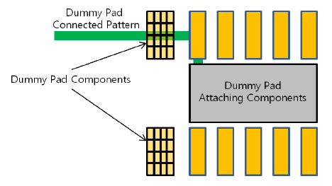

Exclude checking for NC pins connected to specific nets.
Exclude Checking for Dummy Pad Connected Net: This is another
void-checking option for routing pattern, connected to dummy
pad.Figure 6.
Dummy Pad Component: Set dummy pad component group.
Dummy Pad Attaching Component: Set dummy pad and connected
component group.
