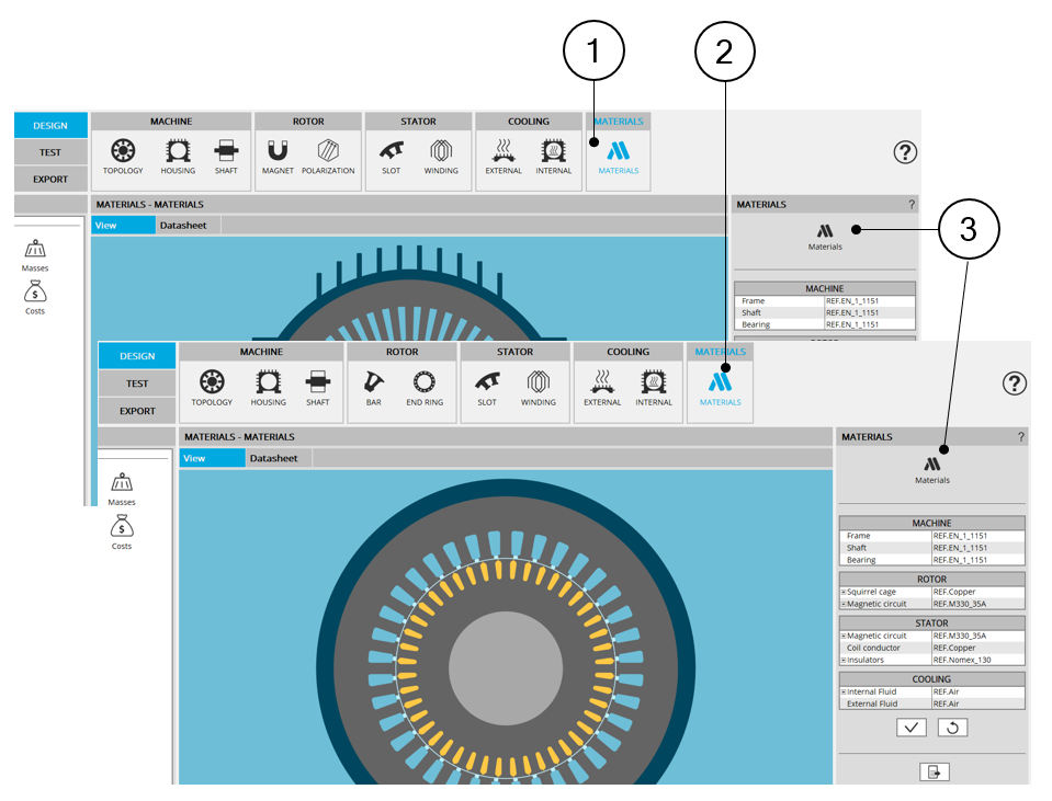

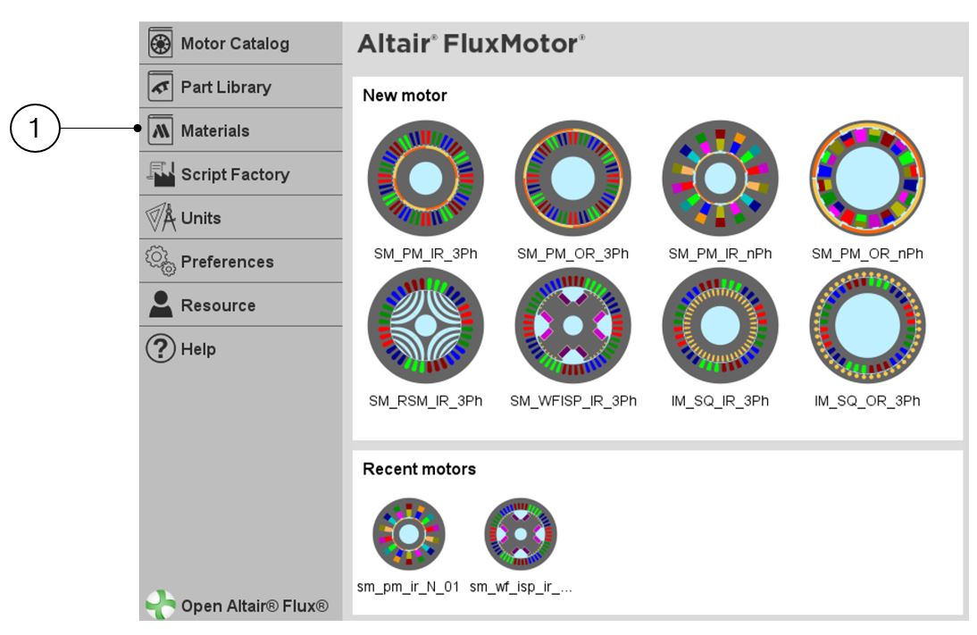

2.How to get into “Materials”?
- From the supervisor, click on “Materials” button.
- From the Motor Factory DESIGN area, it is possible to check the properties of materials through the STATOR/MATERIALS section, in ROTOR/MATERIALS section or in STATOR/WINDING section.
| Click on Materials on the left part of the supervisor to open “Materials” application | |
| How to get into “Materials” from Motor Factory? | |
| 1 | From Motor Factory / DESIGN / ROTOR / MATERIALS section. |
| 2 | From Motor Factory / DESIGN / STATOR / MATERIALS section. |
| 3 | In “Materials” environment of Motor Factory, the Material database can be opened by clicking on this button. |
