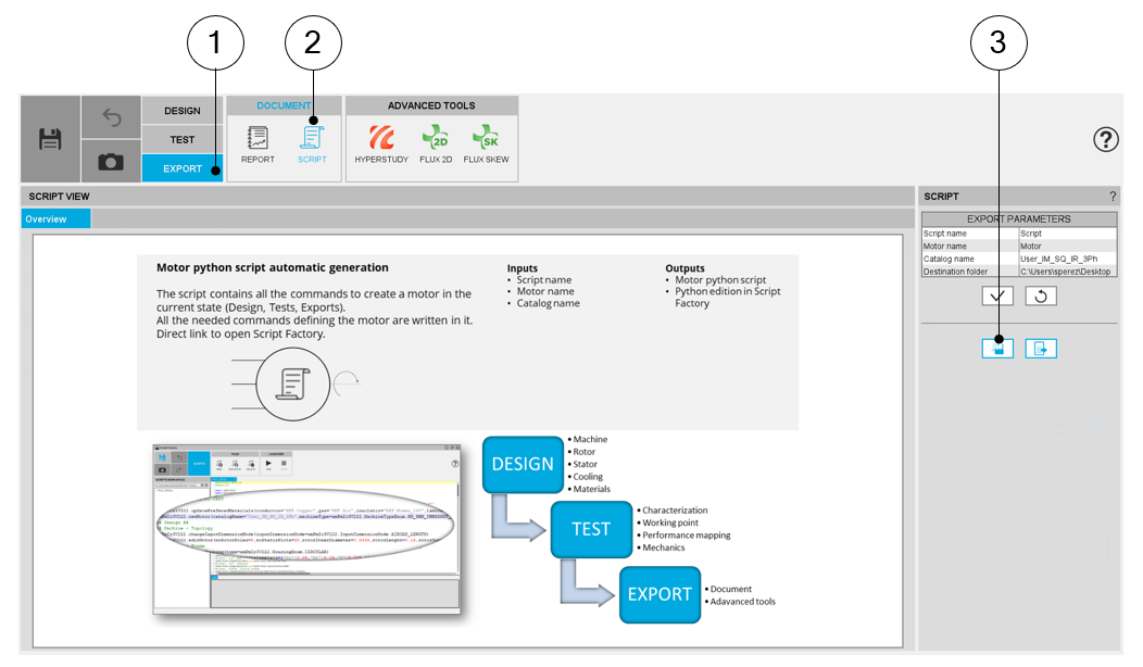

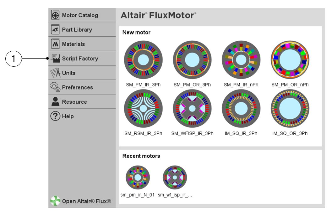

2. How to get into Script Factory?
Two ways are possible:
- From Supervisor, click on “Script Factory” button
- From Motor Factory / Export environment / Script, it is possible to open the python script of a current motor with all the needed commands defining it.
| 1 | Click on “Script Factory” on the left part of the supervisor to open the “Script Factory” application |
| How to get into “Script Factory” from Motor Factory? | |
| 1 | In Motor Factory, select EXPORT environment |
| 2 | In EXPORT environment, select SCRIPT in the DOCUMENT menu |
| 3 | In “SCRIPT” panel of Motor Factory, open the python script of the current motor by clicking on this button |
