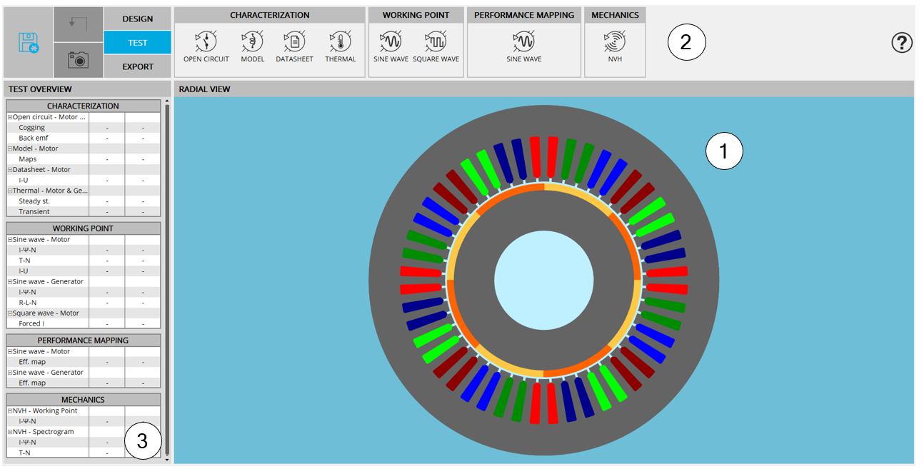

The test area home page includes three main zones
| Home page view of the test areaExample for a Synchronous Machine with Permanent Magnets and Inner Rotor | |
| Zone 1 | Visualization of topology of the machine being studied. |
| Zone 2 | Visualization and access to the different test packages classified into families. One clicks on a package’s icon opens it and gives access to the tests stored in it. |
| Zone 3 | All the test names are displayed in this zone and classified under test families and test packages. |

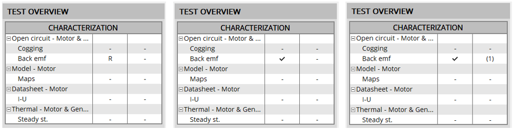

When no test package is selected, an overview (“TEST OVERVIEW”) appears, giving more details about the status of each test.
Here is an illustration for Synchronous Machine with Permanent Magnets
| « R » : Test is running | « ν » : Test is already performed | «(1)» One test is saved |
Clicking on a test row shows the operational area dedicated to the corresponding test.
