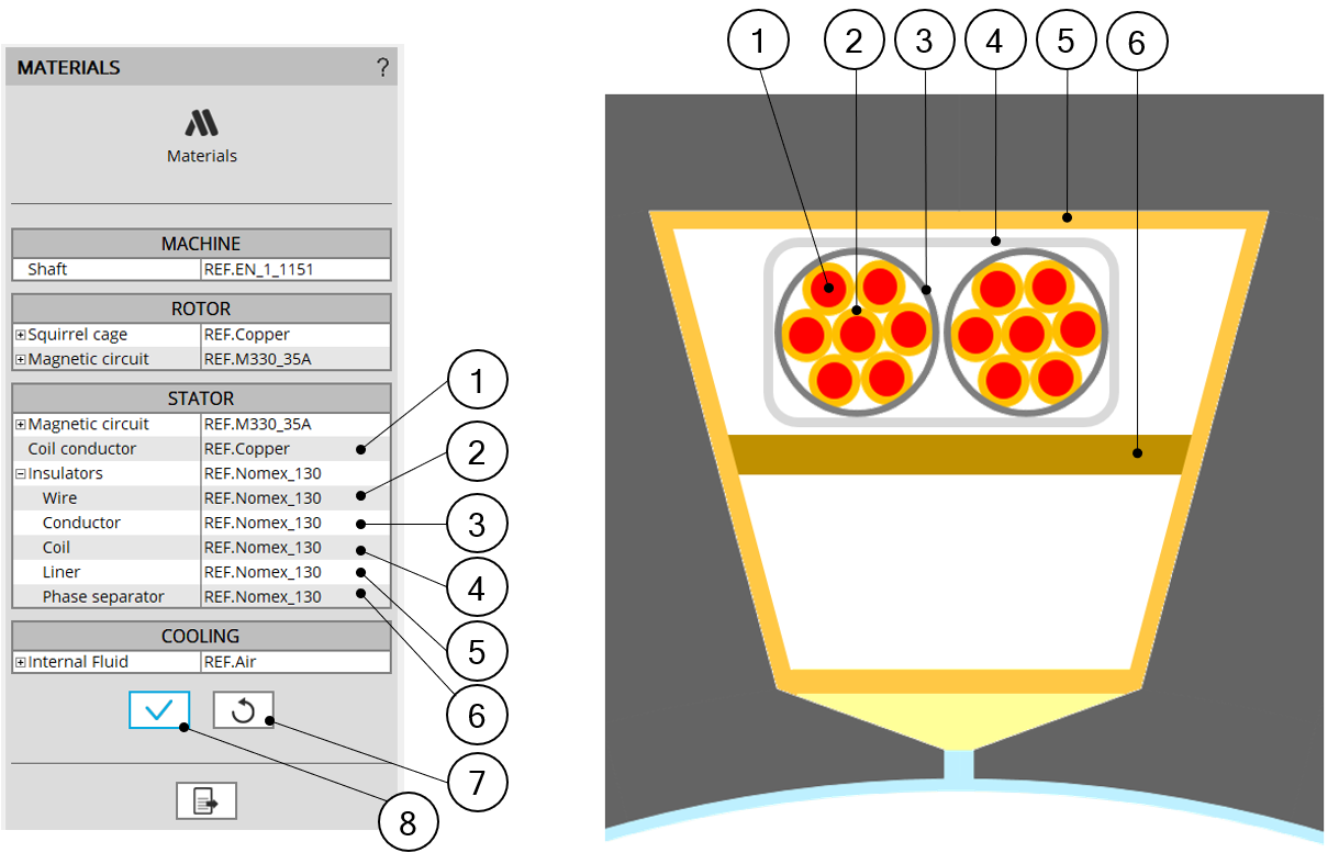

| Building the winding architecture – Choice of winding MATERIALS - Conductor and insulation | |
| 1 | Conductor materials |
| 2 | Wire insulation |
| 3 | Conductor insulation |
| 4 | Coil insulation |
| 5 | Liner |
| 6 | Phase separator |
| 7 |
Button to restore default materials. Default materials are those defined as favorite materials in Material database. See “Materials” application for more information. |
| 8 | Button to validate assignment of materials. Pressing the enter key twice applies inputs too. |
| * | Insulators: If all the above choices are same material, then the corresponding material name is written in the insulators field. Otherwise “Diversified” is written in the insulators field which means there are different materials. |
