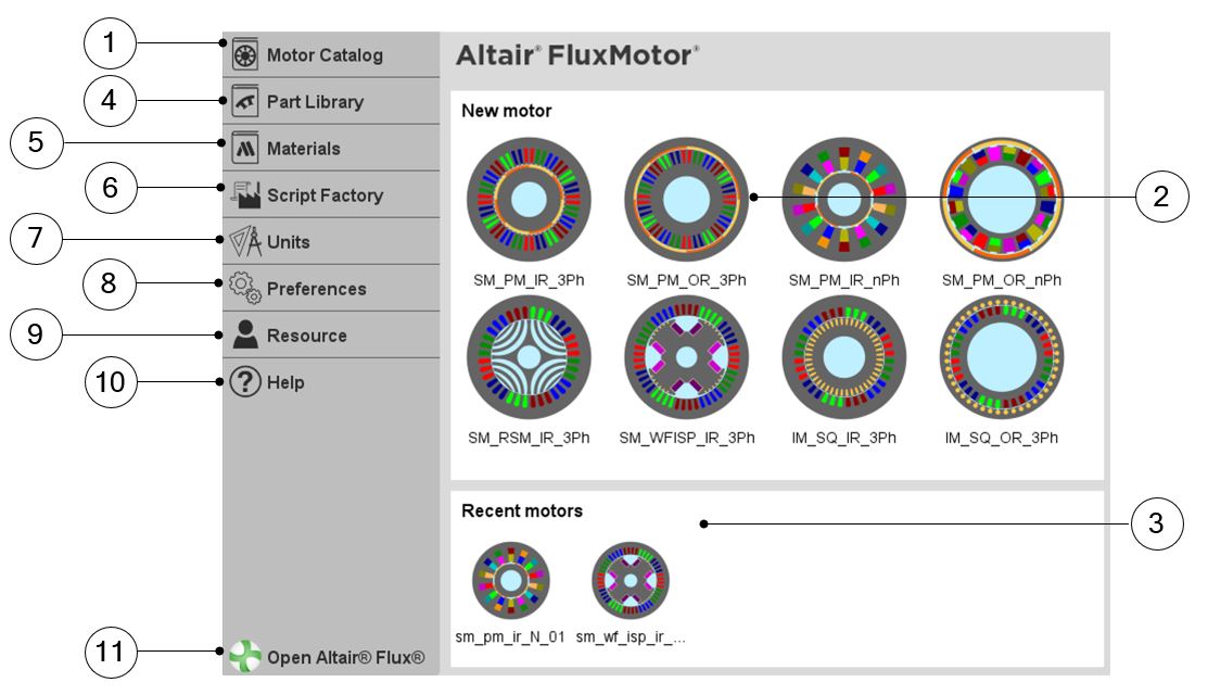

The aim of the supervisor is to group all the needed applications to build and manage the motors.
Supervisor is the first dialog the user comes across and it displays all applications used to build, test and compare motors.
| Applications available from the Altair® FluxMotor® supervisor | |
| 1 | Click on Motor Catalog. Refer to and manage catalogs, compare and choose motors. |
| 2 | Click on a type of motor and get into Motor Factory for designing and
testing motors. 8 types are available:
| 3 | Click on a recent studied motor and get into Motor Factory for designing and testing motors |
| 4 | Click on Part Library. Refer to and manage parts: choose, modify or create |
| 5 | Click on Materials. Refer to and manage materials: choose, modify or create. |
| 6 | Click on Script Factory to create and run scripts for driving FluxMotor® applications. Available in user beta mode (See user preferences). |
| 7 | Click on Units. Refer to and choose the units available in FluxMotor®. |
| 8 | Click on Preferences to choose user preferences. |
| 9 | Click on Resource gives access to Altair Connect. |
| 10 | Click on Help gives access to Online help, Licensing system and information about FluxMotor® and Altair Simulation Products |
| 11 | Click on Open Altair® Flux® to launch Flux directly and quickly from FluxMotor® supervisor |

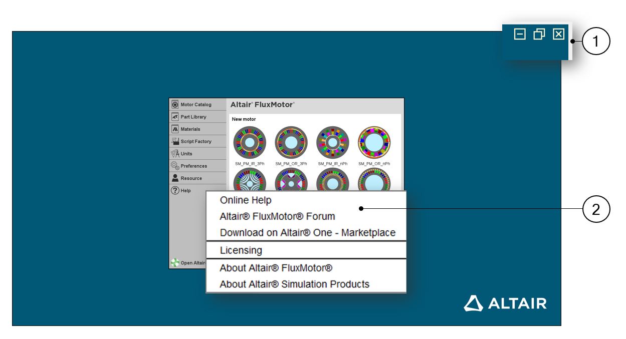

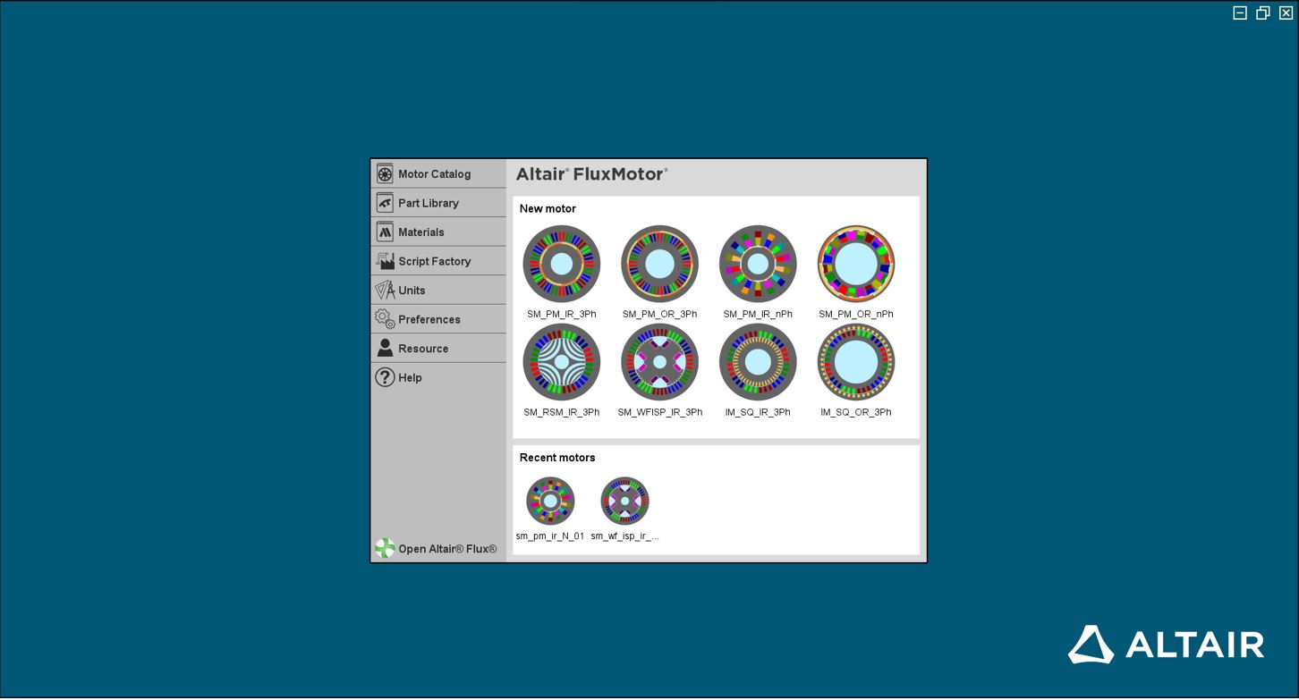

5. Desktop of Altair FluxMotor™
The FluxMotor® desktop contains the Supervisor.
| Presentation of Altair® FluxMotor® Desktop |
The supervisor (desktop) of FluxMotor® can be reduced by using functions (buttons) on the right top part of the screen.
| Miscellaneous functions of FluxMotor® Desktop | |
| 1 | Management of the size of FluxMotor® Desktop. |
| 2 | Expand the menu Help to access to
Online Help, Licensing
system and information About FluxMotor® and
About Altair Simulation Products Note: The section About FluxMotor®
allows finding the reference of the current version of
FluxMotor®. |
